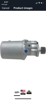

My power steering pump looks nothing like the one in the manual. Looks more like this one IMG_8431.pngIMG_8431.png
I don't know what "manual" you are looking at, however there are 3 different pumps shown in the parts book I posted the link to.
Page 205 (use the index at the left of the page) is for the Continental engines; it is not anything like yours. You say you have a Perkins diesel engine, so you shouldn't be looking at that one for the Continental engines.
The power steering pump on page 201 is for the tractors serial number 9A 111877 and up, with a Perkins engine. It appears the pump body is somewhat oval like the one in the picture you posted.
The power steering pump on page 202 is for the tractor serial numbers prior to 9A 111877, with a Perkins engine. Its pump body appears to be more of a rectangle. There are several foot notes related to that pump at the bottom of the parts list. The last footnote (L) tells they used the pump on page 201 as the service replacement for the one on page 202. A couple lines had to change along with an O-ring to use the later pump. The info is in the footnotes.
