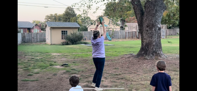

Attached are some not-so-great photos of the current shed I will be taking down, and adding to the concrete slab that is there. It is a 12 ft. by 13 ft. shed and I have about 10-12 foot on either side to add on, about 10-12 foot at the front extra, and have about 7 foot to the rear extra.

If you enlarge it where are the kids going to play? Looks like the yard is one big playground with a zip line. Maybe everyone needs a zip line from the house to the barn and back.

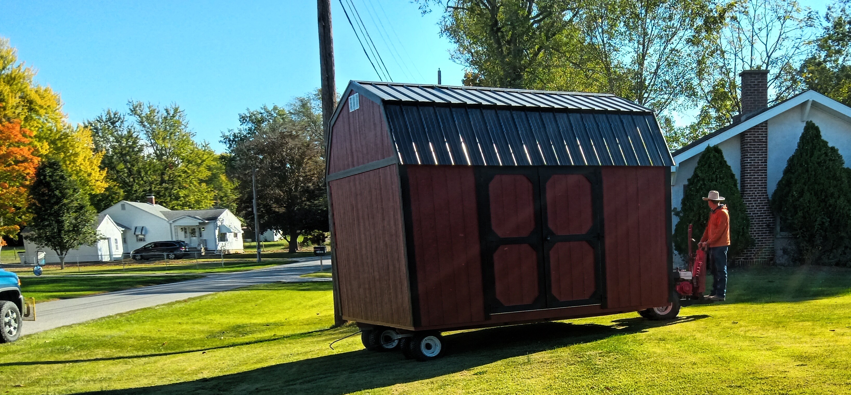

My neighbor had a shed delivered the other day $4500. I would sell your shed, not take it down.
I posted a pic of a neighbor getting a shed delivered. Find someone to move your shed. They are worth a lot.
