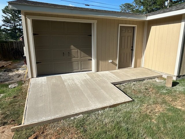

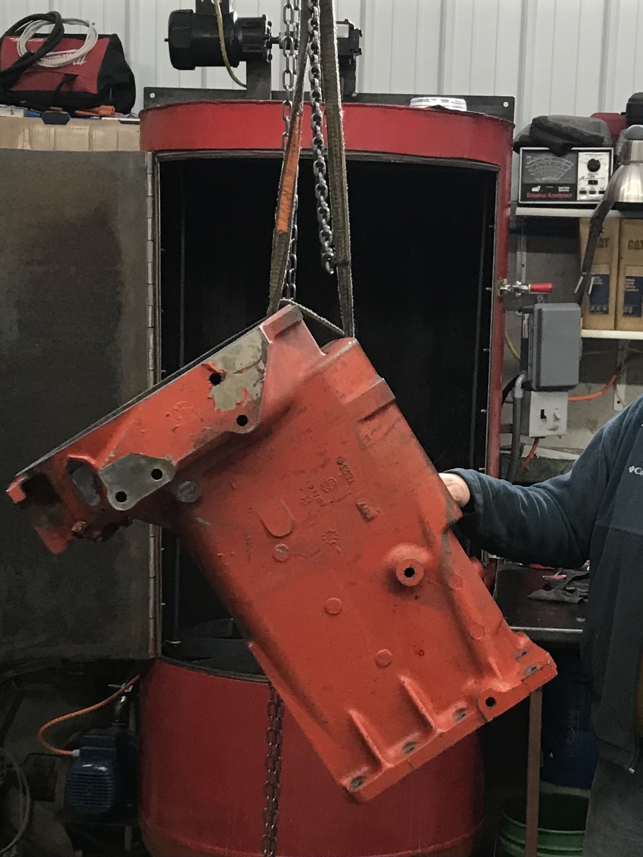

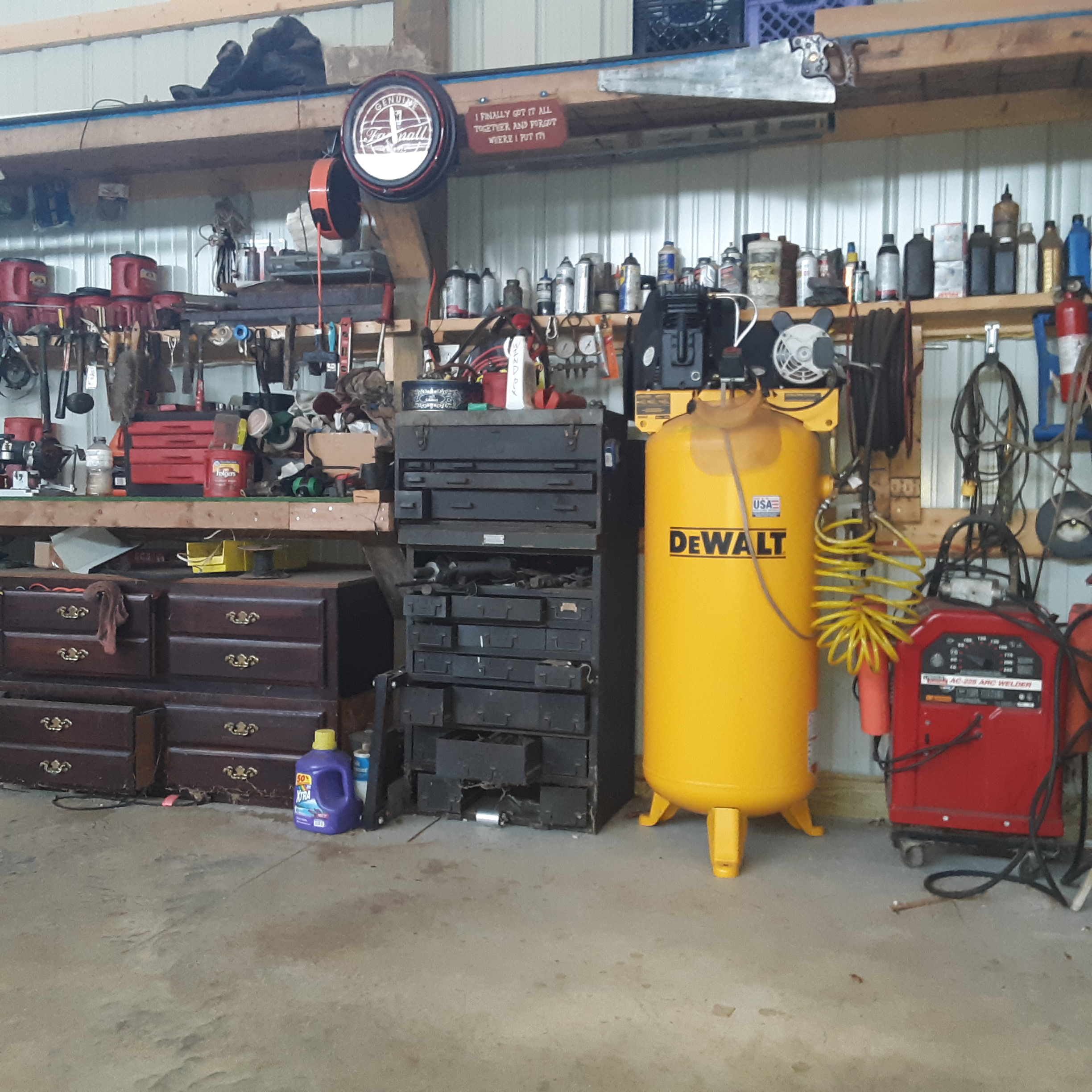

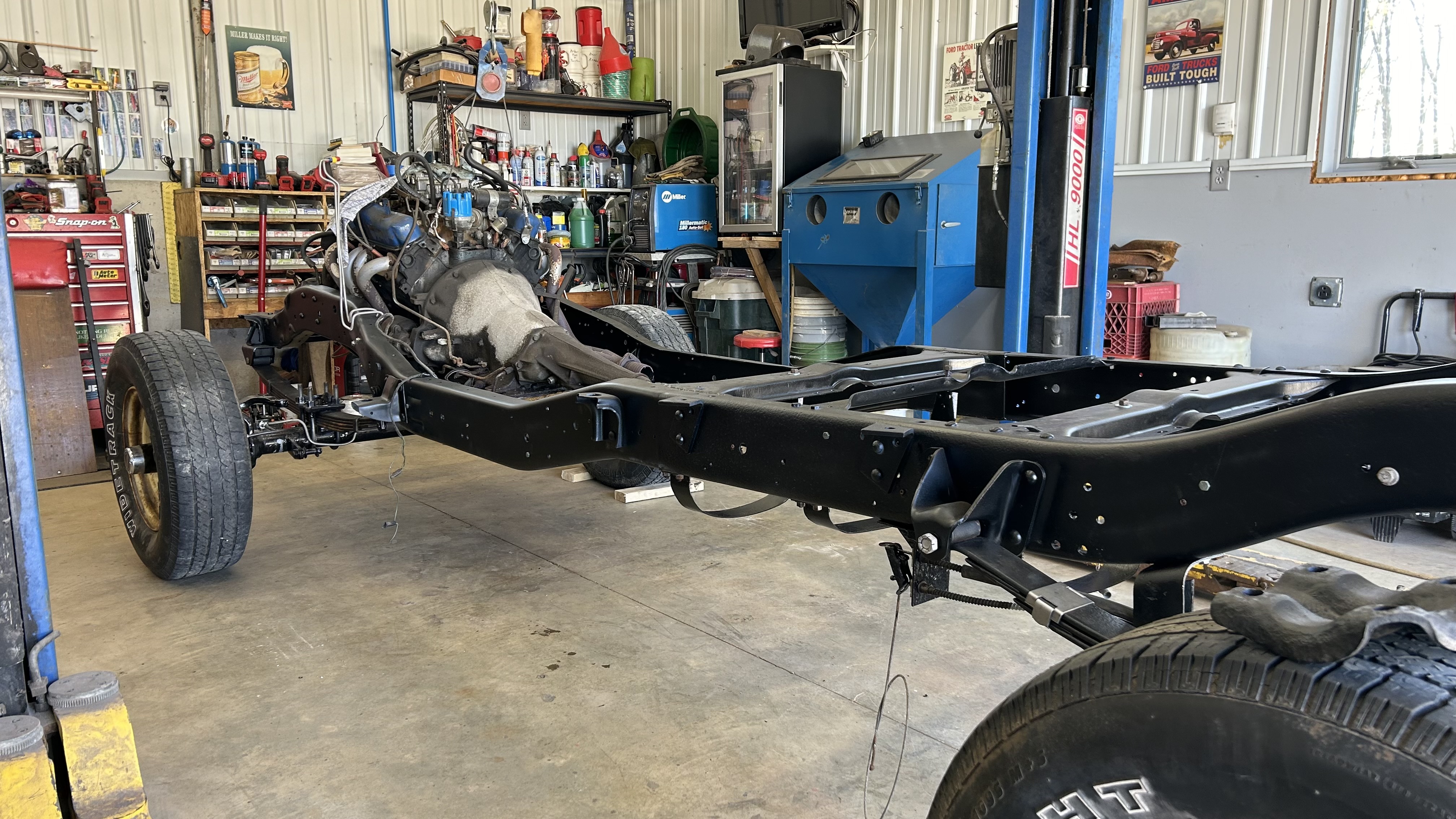

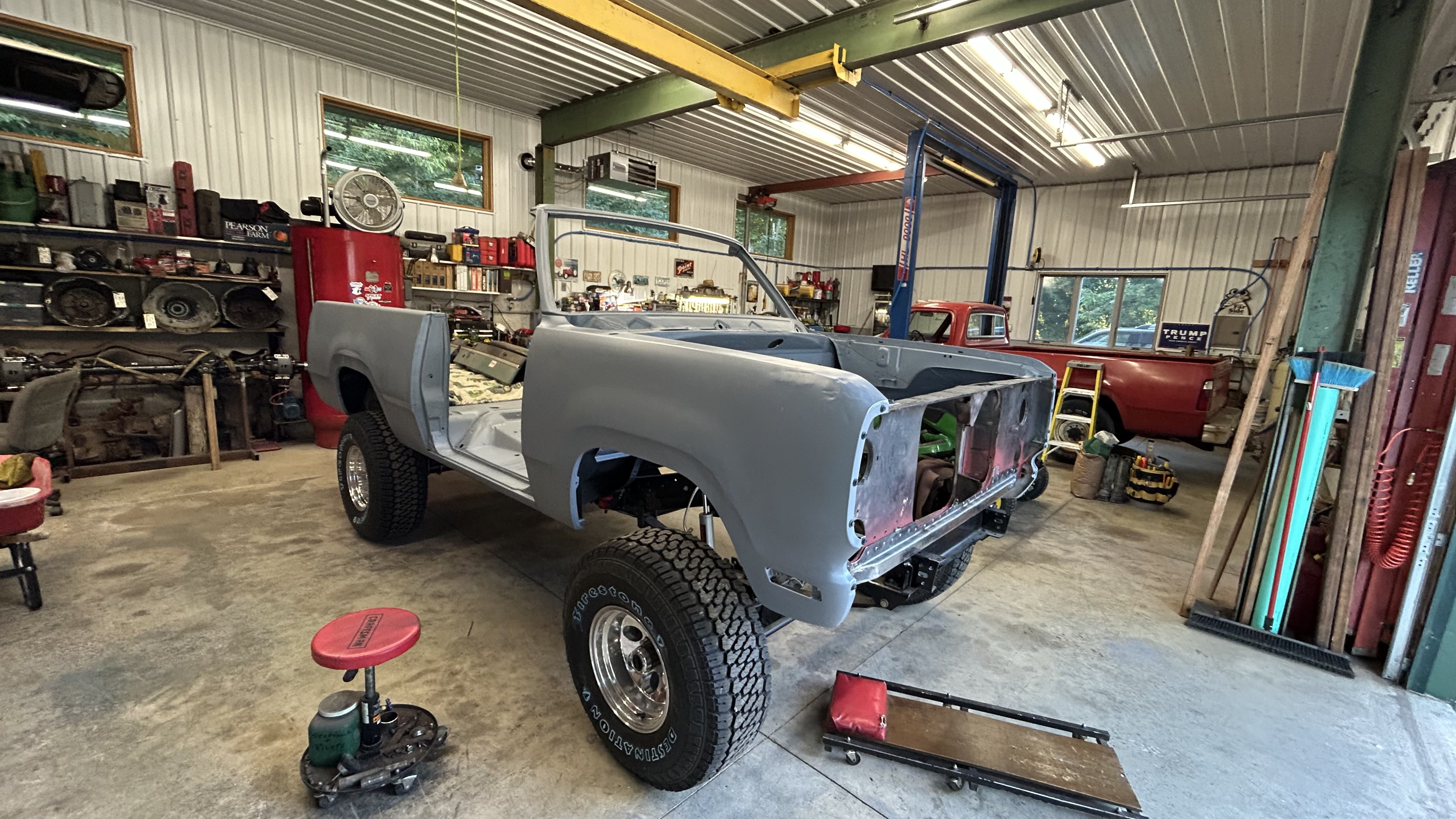

Beer refrigerator for neighbors and son in laws, couple chairs and height! Here’s mine, hot water parts washer, blast cabinet, car lift you can use for more than cars and overhead cranes. I’m not getting any younger!

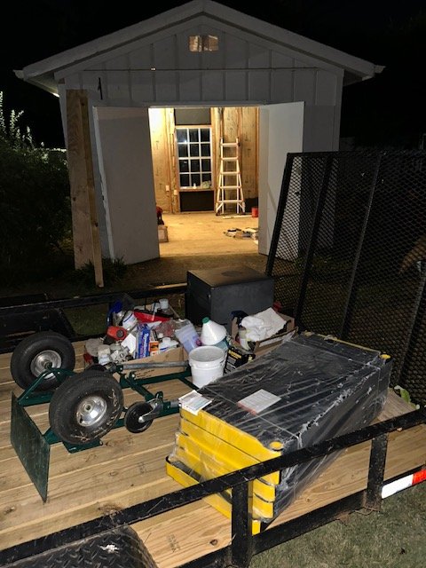

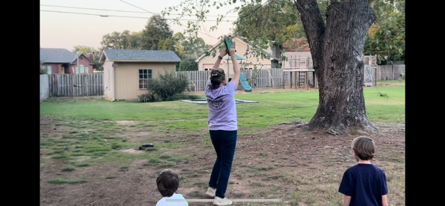

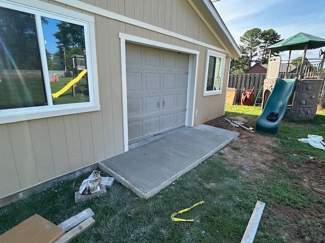

Attached are some not-so-great photos of the current shed I will be taking down, and adding to the concrete slab that is there. It is a 12 ft. by 13 ft. shed and I have about 10-12 foot on either side to add on, about 10-12 foot at the front extra, and have about 7 foot to the rear extra.
View attachment 90876View attachment 90877

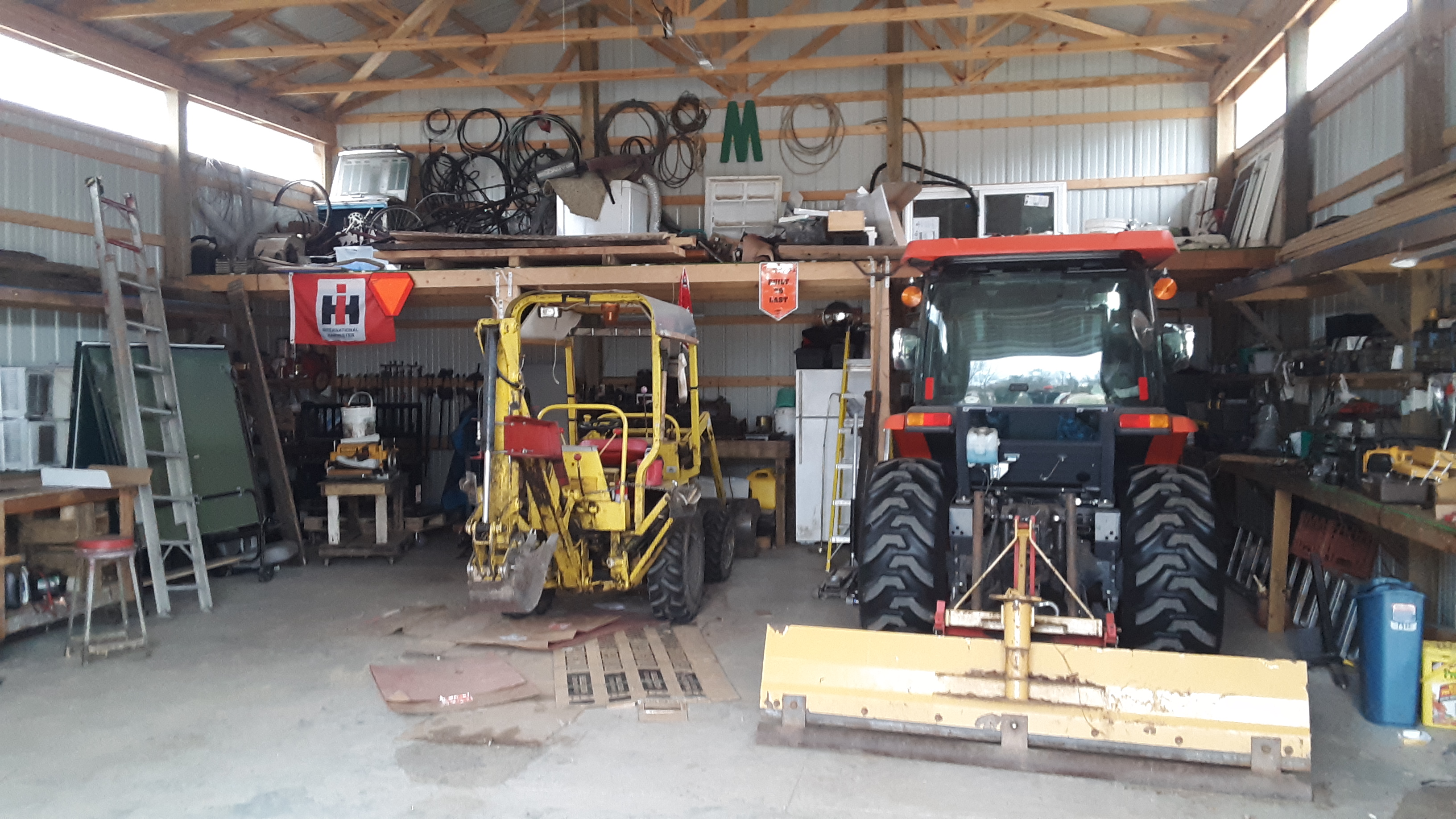

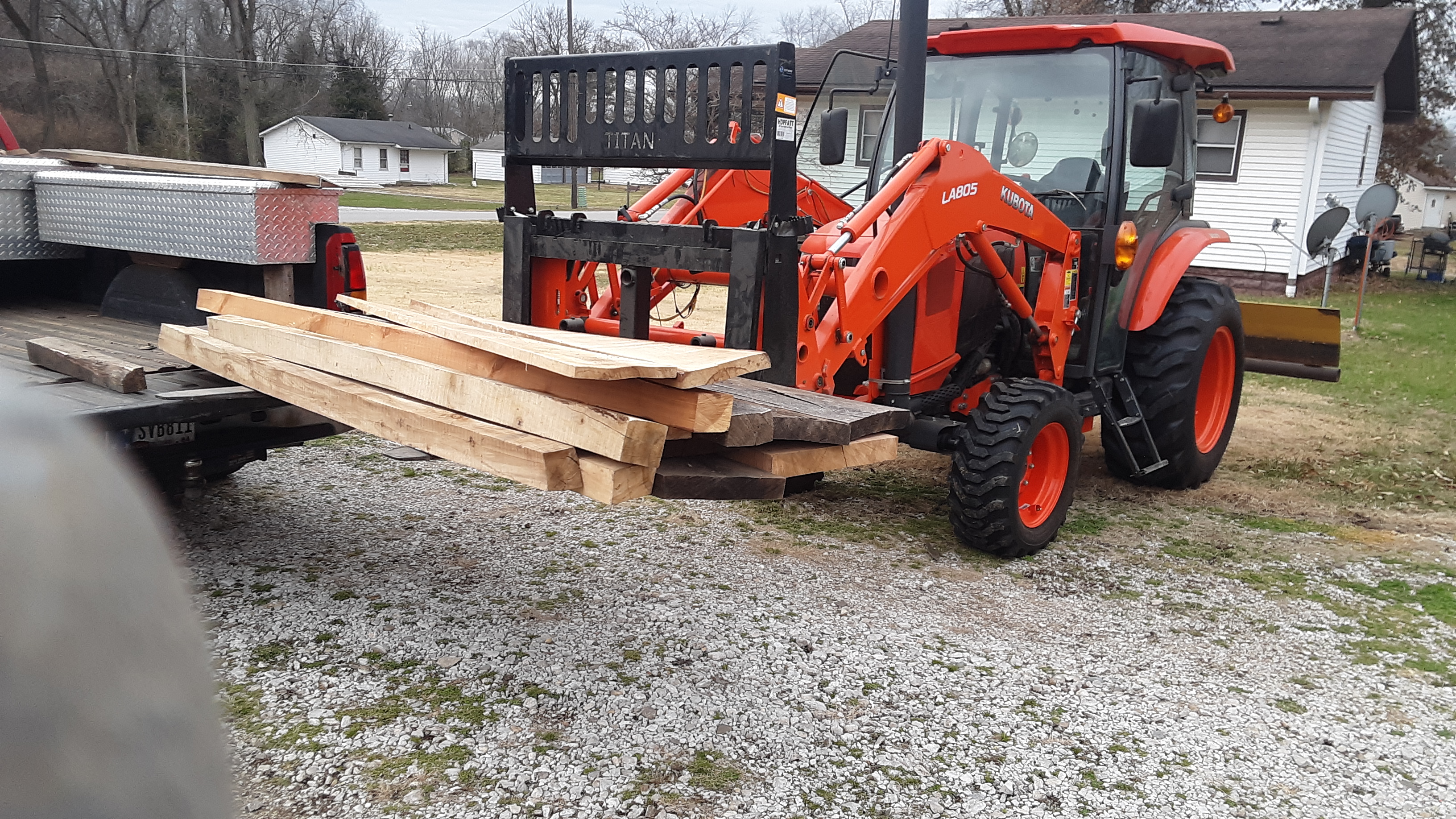

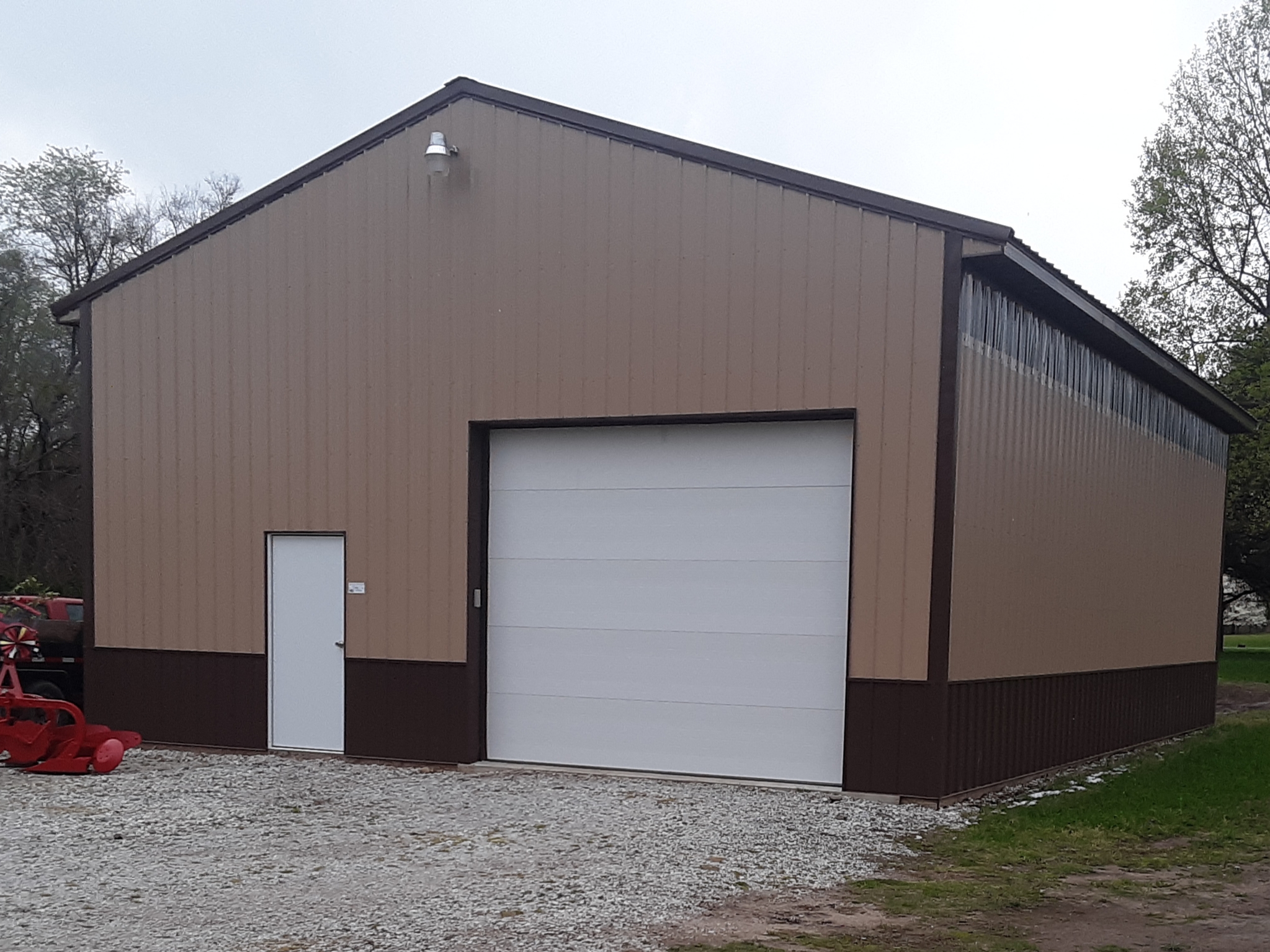

In 2019 I built a 30x40x14 pole barn for $16400. I use my Kubota as my elevator to the loft. I recommend windows under the eves. Ridge vent ,, eve vents and 6 inch concrete floors with wire, not fiberglass in concrete. View attachment 90986
You can never have too big of a shop.
Go taller means you can add a loft.View attachment 90982View attachment 90984View attachment 90985
