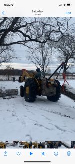

Good work on getting her going! You may be interested in because you mentioned hauling logs... I have a massey 205 I converted to a designated log hauler skidder. Made this rear weight concrete ballast that holds a vice, cant hook, winch and chainsaw, also mounted a 12 ton winch and log tongs for pulling logs and added this small boom for dragging trees out of woods and getting most of it off the ground. Also has a standard 2 inch trailer hitch attachment. Added quick attach to the front so I could use a grapple to load logs on a trailer after skidding them out of the woods. It really works great for that type of work. This is all for my sawmill work. I don't have the grapple on in the pic.
I figured the ballast added another 800lbs, tires are loaded. This thing is a beast in the woods. You need all the extra weight in the back for traction.
