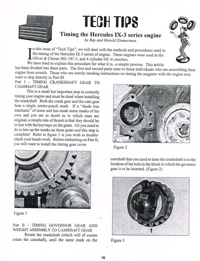

The ignition timing is unrelated to the engine timing - the relationship of valves opening and closing wrt the pistion position. If that is incorrect, the engine will not perform. If your pressure guage is reading near correct, I suspect the timing is out by a tooth or two or a few.

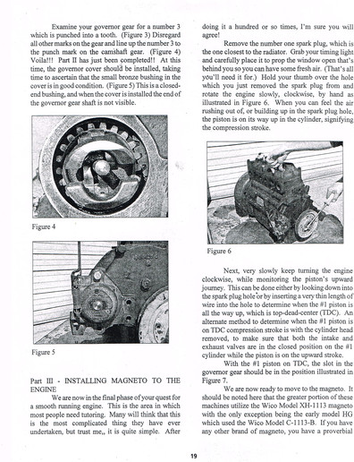

what is the best way to time the motor. Is there a procedure to time the valves and what not aside from the ignition.

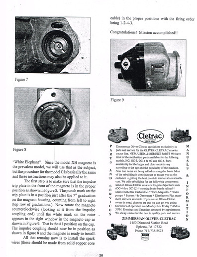

I have a 1955 OC3 w/Hercules IXB3 motor. Compression should be at least 100 - 110 PSI. There is a timing mark on the flywheel visible
through a hole in the bell housing on the magneto side. Typically the flywheel is stamped with "SP" (spark) and should be visible through
the hole when number 1 cylinder is at TDC. If the cam gearing has been changed, Zimmermans has a document describing how to re-time the
gears.
There are probably several ways to achieve a result, but the easiest is to follow the engine manufacturer's instructions, for which they will supply gear markings, to be matched up at rebuild, with the number one piston is at TDC (crankshaft timing - assuming, her, that the flywheel has been fitted correctly, if the bolt pattern is not asymetric).
RAB
If you are confident your ignition timing is correct and you are getting a spark in each cylinder at the right time then the next thing to do
is check valve seating. This can be done with a leak down test or remove the valve cover and plugs, rotate the engine by hand and check that
the valves seat correctly. There should be .006 - .008 gap between the push rod and valve stem. I've had to grind the bottom of a valve to
get the proper clearance. I try to post Zimmermans Engine Timing document here.
Thank you for the info. I talked to me Zimmerman and the timing is correct. So I have other issues in the motor
