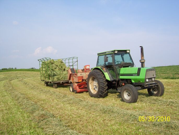

One thing we did years ago was add bars across the corners of the front of the wagon. That description may not be the best but you can see on the wagon in the picture I have included. Very easy to do. The picture is a random one I had...wagon is not full enough to show utilizing them yet.

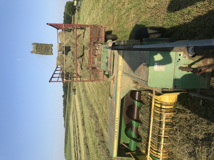

If you have a JD Pan Kicker, you can make the front of the wagon as high as the arch of the throw. In this pic, 100% of the bales were put on the wagon by the pan kicker.
