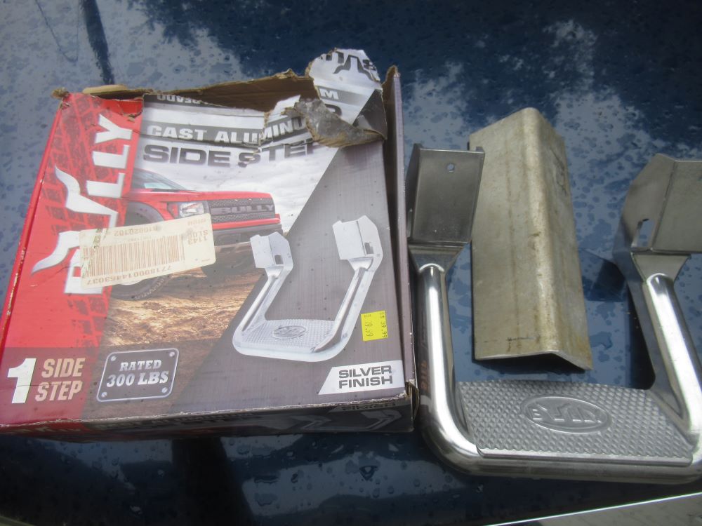

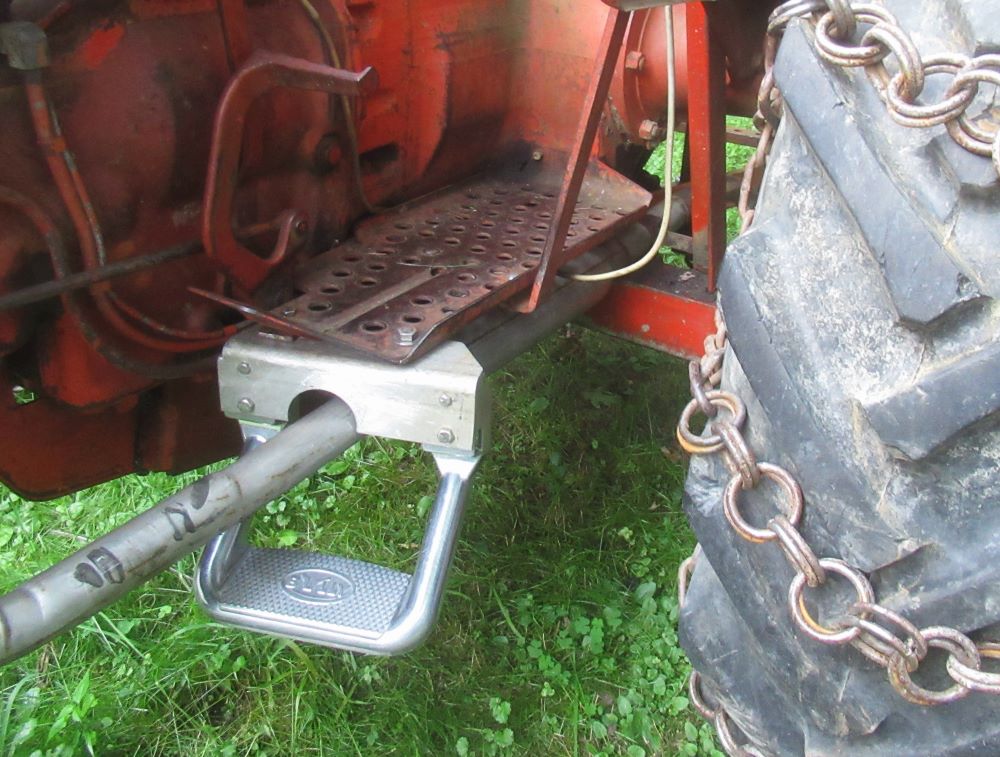

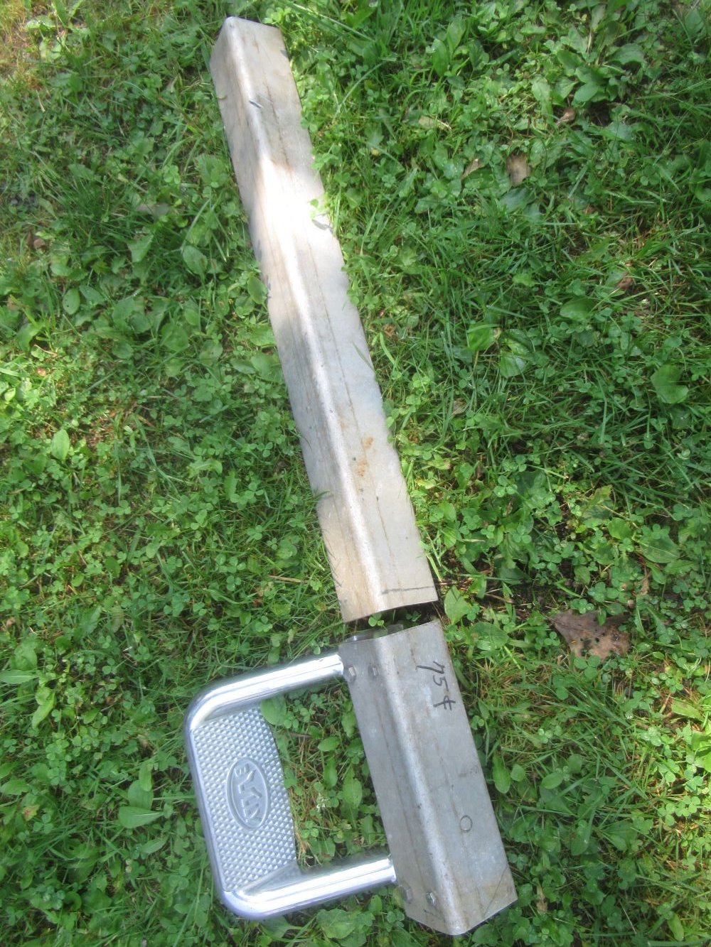

As much as I hate to admit it, at 83, I find it a bit more difficult to get around anymore.
I ain't complaining mind you......I am still gettin' around......just not as well as I did a few years ago.
I found this truck step at Tractor Supply a few weeks ago for 1/2 price (20 bucks) and I thought I would
put it on my D-17 to help me get on and off it a little easier. I paid 75 cents for a three and a half foot length of 1/4 X 3 X 3 aluminum angle about 30-35 years ago and its been "in stock" ever since.
When I bought it I just knew I would find a use for it "someday". Well, today was that day.....I got to use at least a piece of it.
Having the underslung exhaust made the installation a little harder but still not too bad.

just for safety u might want to put mesh guard or something so a person dont burn his leg. but i know us old guys wear our steel toed boots and long pants. not like the young generation in jesus sandles and shorts. lol
I think you will find you need a bit more support out the back side so the angle doesn't bend letting the step tip downward with the weight on it. A second piece of that angle bolted in behind so it makes a tube shape and welded would give it a lot more support.
That is a good observation and a good suggestion.
I installed two pieces of 5/16" flat steel running back along the bottom of the foot rest which seems to be enuf......I'm only 170 lbs and this seems to be OK for me.
