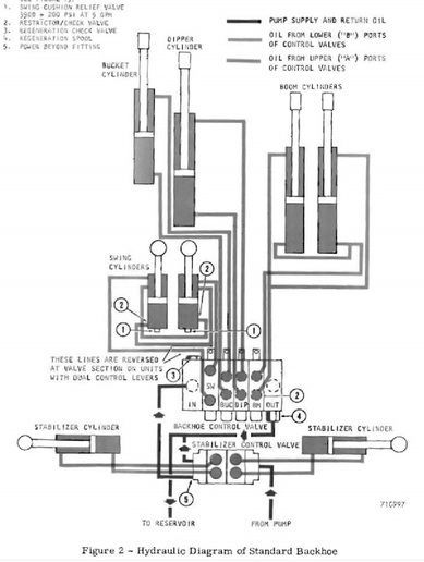

Hi Ive been working on my neighbours old case 580 ck. I think ita a 73 but might be older, has a modell 33 backhoe. We had the hoe off , removed and
resealed the control valve body. Previous hands had been at it before I got there so some things are a mystery. A restrictor fell out of one hose when
we moved the valve body and we are unsure of its location. Also we are a little uncertain of hose location and control linkage. We dont have a manual.
Any pictures or manual references would be welcome. Thanks, Jim

I think the restrictor is for the boom drop, bottom port of the boom section valve, I will try to post the layout of the hose routes, there were a few different backhoe layouts, foot swing, extending dipper etc, the one shown is a standard 33, you will have a lot of trial and error, remember each cylinder has two hoses so trace the hoses from the cylinder in pairs and connect them to the top and bottom ports of the same valve, test things on low idle so if wrong you don't burst hoses.
AJ

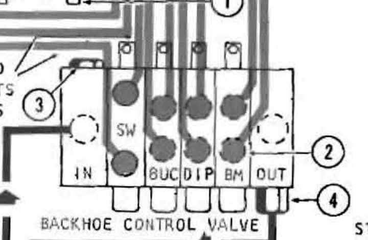

That did not come out very big, I have tried again with the hoe block only so you can see it a bit better where the lines go, swing left, then bucket, dipper and boom.

thanks AJ from what IVe read I assumed the restrictor was for boom drop but we were uncertain. to clarify it does have the foot pedal swing

I checked the online parts list and it for the boom drop, bottom port of the boom valve.
