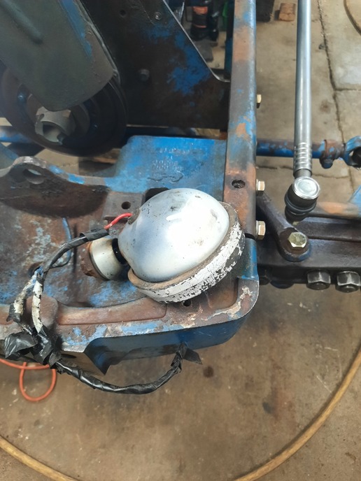

This was on my S/M, had Saginaw pump but pretty sure rest was factory.
[/img:e51c3efd13]

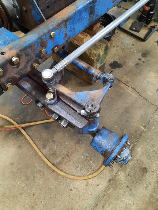

This is a great topic, last winter I sold the PAS and purchased a drag link from Agriline to go back to manual steering. I had no idea there was a defference in steering arms so after reading cdmn post I looked in parts book and there is 2 p/n's. Then Majorman and SkipperII chime in that the gusset is the difference. What a relief it is to hear that!
Was working on it today, this is a PAS steering steering arm on a M/S tractor.
