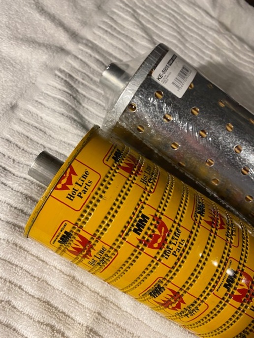

Just a few pictures of the original MM oil filter for the '53 UB next to the replacements that are currently available. The newer ones are a bit smaller in diameter and a tad shorter, but seem to work OK. I have one of the newer ones in the UB now. No apparent issues.

A trusted guy at NAPA just shook his head at me today when I asked about U or G MM filters. OK. Knew that fact.
rusty, I've been in touch with Henry Leasing parts dept myself just today.
Like MnBoy says, they have 50+ FE5095 filters in stock as of this morning.
Mexico plant, built for Henry Leasing in batches, brown paper folded element and a steel housing.
24.17 each. Maybe order an o-ring at 2.50 also.
I should have ordered a filter and seal ring. Need to for my project.
Thanks for the tips MnBoy! I'm catching up!
There it is! A tad shorter! That tiny detail has been racking my brain!
Do we need a spring to hold it down in the filter housing?
They need to be held down.
I'm about to butcher a Fleetguard LF-584's 1/2" ID top to show another option.

Is there enough spring pressure to keep shorter
filter tight?

I wonder how much pressure it would take. Oil flow is from the outside-in so perhaps not as stout of a spring as I would imagine.
