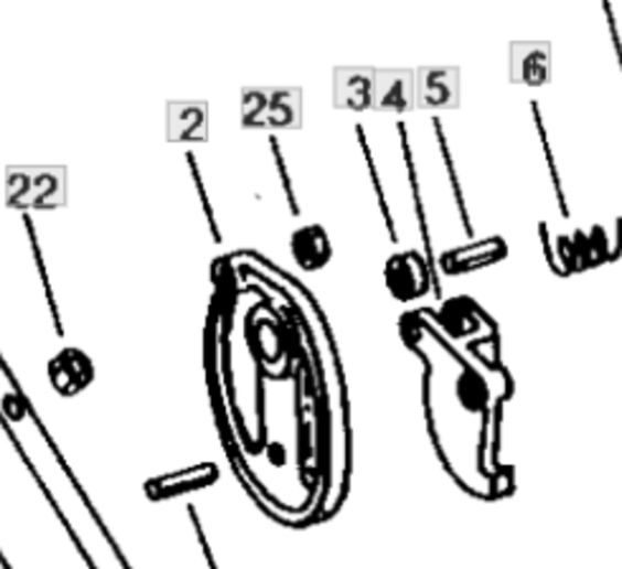

Bought a nice 346 1980 Baler last year and has worked great! until today....wire tie- seems to want to attach a 8-10 bale on the back of another bale then it will mess up and wrap wire around the bale-hook shaft..... any help for me? Thanks

Are you stating baler will put wire around an 8''-10'' thick block of hay after tying a regular bale? If that's correct the bale measuring arm isn't dropping to the adjustment stop after bale has been tied. Is spring(key 4) present or AWOL? It's also possible measuring wheel brackets(key 5) are slide a little to far to the rear. How much contact area does arm(key12) have with needle lift trip dog(key 4)?

The key # is referencing a particular part identified in a parts photo that I posted.
For clarification if I understand you correctly your bales are staying connected by stems of hay after leaving bale chamber. If that's correct then I think plunger head & stationary have too much clearance between them.
To move plungerhead closer to stationary knife loosen bolts under balecase retaining LH bottom guide & utilize 3 jack bolts to move guide & plungerhead closer to pickup attachment.
