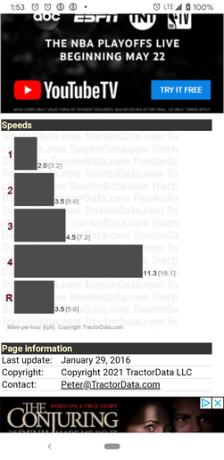

Here is tractor data for the model B that I will be using to pull this rake. What gear and throttle would you go with knowing the speeds it can do I'm assuming at wide open throttle is what these specs are for...(2.5 mph -I'm guessing all those speeds are wide open throttle?)
Also how fast would you run a trailer type sickle mower in 3 ft tall orchard grass? Here are the specs for the model CA I will be using to pull the sickle mower...(2.0 mph)
Thanks much for the rake setup info, should I need to adjust the left hand crank above enclosed gear.box?
