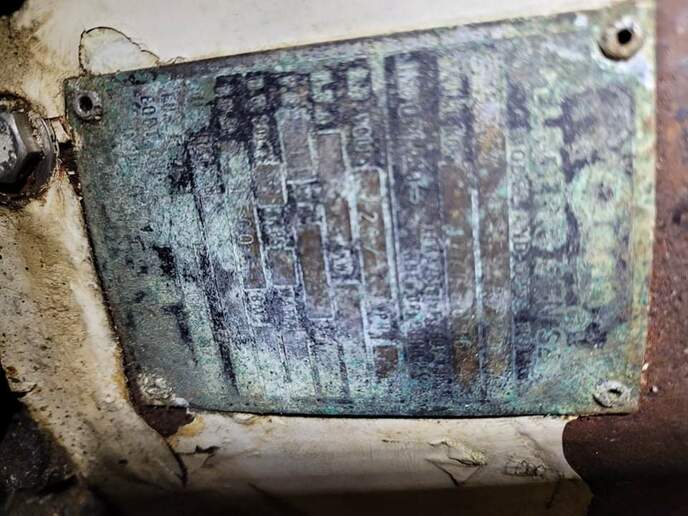

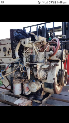

This unit is for sale near me . I've no knowledge of Onan equipment and wondered if any of yo might be able to identify the model and engine type . The spec plate is too obscure to read , seller can't provide any details either.
I thought it might be useful as a power supply for the farm , old , not too expensive and won't be asked to produce enormous amounts of power .

Any numbers on the circuit breakers? That would give a ball park clue.
Double breakers, single phase, triple, 3 phase.

Looks like a RDJB gen set, looks liquid cooled, DJB would have been air cooled. Probably 6.0 or 7.5 KW, what type of voltage regulator does it have? There were different types used over their production run.
I have no doubt it will run, making power is the real question.

The arrangement of injection pump, filters, shutdown solenoid, etc suggest a 6DJ series. And the presence of cooling and raw water pumps would make it a 6MDJB - the liquid cooled, marine variant of the air-cooled 6DJB.

It would be rated 6 kw - voltage and whether single or 3 phase depending on the generator head. If you can't make out the spec plate you may be able to back into the model by getting the part number on the voltage regulator then doing a search on that. (Regulator is under the top cover over the ammeter.)
With proper care DJ gensets are about as reliable and bullet-proof as can be had!

There should be six numbers stamped onto a machined pad , around the oil filler area, toward the generator adaptor. Might have to remove some paint/rust to see them. That is the serial number. If you post that number in the Onan generator section of SmokStak.com, someone there can tell you all the particulars about it.
To me, it appears to be a 7.5MDJE (60Hz), based on the style of the injection pump. Two cylinder Bryce-Kiki pump. Raw water and circulating pumps on the shelf, belt driven. Slightly lower rating at 50HZ.
Go to http://skilledcrafting.com/onan files, or http://onan.xmsi.net to get service and operators manuals. Search on MDJE. It has an Onan YD generator end, electronic voltage regulated. Mechanical governor.
You would need a radiator and some type of cooling fan, unless you have a pond or stream from which you can get cooling water. Maximum lift of the raw water pump is about 6 feet (2.8M). Very good unit, but noisy.
Both the engine and generator were designed and built by Onan - no one else. So it is not "similar to. . .", or built by . . ." . Of course the water pumps and injection pump were built by someone else; no point in reinventing the wheel.
