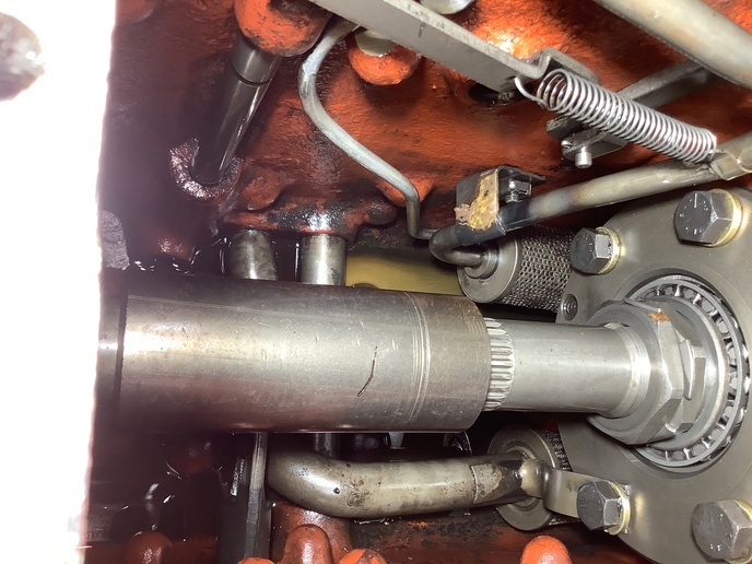

Sorry I can't help with your specific issue, but I'm working on my hydraulics also. I'm trying to replace the suction filter, but it doesn't appear easy to remove because the tube its attached to has been brazed to a piece that's fixed to the housing. See picture.
Are there good instructions on here how to replace these? It's not documented in my Ford Repair Manual - only that they need to be cleaned or changed regularly...

PostPosted: Tue Jun 15, 2021 7:28 pm    Post subject: Re: Hydraulics Ford 3000 Reply to specific post Reply with quote
The head of the bolt that holds that bracket in place should be on the outside of the casing. Many folks have accidentally unscrewed it thinking it is the level check plug and then found out that they need to somehow hold that bracket in place on the inside while they screw the bolt back into it.

PostPosted: Wed Jun 16, 2021 4:03 am    Post subject: Re: Hydraulics Ford 3000 Reply to specific post Reply with quote
Sean in PA wrote:
(quoted from post at 22:28:42 06/15/21) The head of the bolt that holds that bracket in place should be on the outside of the casing. Many folks have accidentally unscrewed it thinking it is the level check plug and then found out that they need to somehow hold that bracket in place on the inside while they screw the bolt back into it.
Thanks Sean! What's the trick to removing the other filter? I've removed the bolt holding its bracket in place, but I can't figure out how to work the tube out of there.

PostPosted: Wed Jun 16, 2021 5:59 am    Post subject: Re: Hydraulics Ford 3000 Reply to specific post Reply with quote
rss0213 wrote:
(quoted from post at 08:03:00 06/16/21)
The other "filter" is just a metal screen on the end of the pickup tube that's meant to be cleaned and re-used. It doesn't look very bad in there so I don't think you need to pull it completely, but the o-ring at the other end of the tube may be the source of your air leak, and I think you can move it enough to pull the end out and replace the o-ring. I don't think that you can get that whole intake tube out without splitting the tractor between the trans and rear axle. There may be a way that someone else might be able to chime in with, but I don't know of one. I know I had to do a rear split on my 3 cylinder S-O-S 4000, but your 3000 looks less crowded in there so there may be a way.
