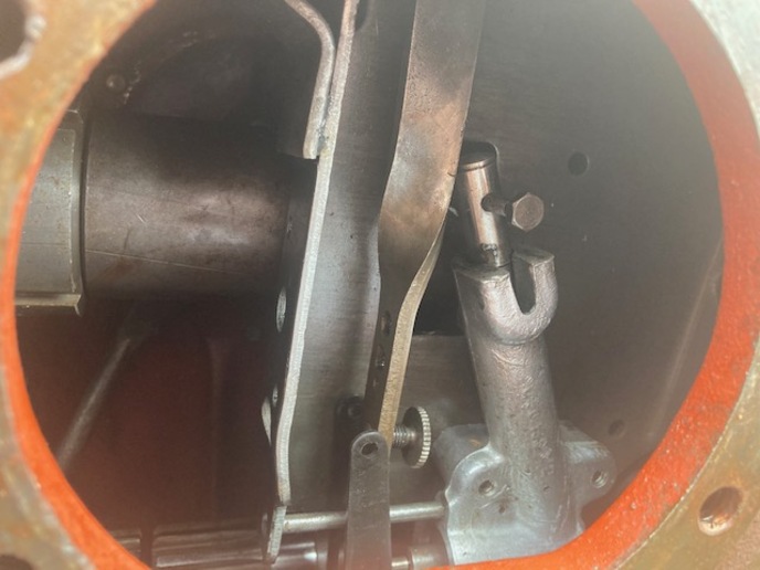

I'm coming along nicely on restoring a 1968 MF 165 and recently split the tractor to install a new hydraulic pump. I reassembled the tractor and made the adjustments per the I&T Manual. Got it running and testing it out. During the final adjustments, Draft Control doesnt function at all - lower links do not raise no matter the position of the Draft Quadrant.
Briefly: Draft control does not work at all; Position control works but seems like it's out of adjustment as the lower links don't begin to rise until I'm 1/3 of the way up the quadrant (and I have the stop all the way back, have to move almost to Constant Pumping to raise fully to Transport Position.
Secondly, the hydraulics seem "weak" - that is, they won't lift full weight, and if too much weight is on there, the arms will go all the way back down. It will lift probably 250 - 350 pounds.
Tractor is a Perkins AD.203 Diesel with Live PTO, WITH Multipower, WITHOUT Pressure Control. Hydraulic Fluid is new, and correct (Permatran III.) Had some general fluid in it the first time around, to flush the system before filling with the good stuff and it definitely is better with the Permatran III.
Motion is slightly jerky on the way up, very smooth on the way down.
I HAVE NOT adjusted the Draft Control spring at all yet - I need to disassemble it. Tractor sat 8-10 years in the same spot so a bit rusted and I'm not looking forward to removing the set screw. But I WILL overhaul the Draft Control Spring soon. I needed the tractor operational to box blade some roads on a deadline and will dive back into disassembly when job is done.

When describing the operation of MF hydraulics to anyone I use two comparisons. Firstly the component parts of the system, the position of the three-
point linkage, the quadrant levers, the control spring and the pump control valve lever MUST all be 'talking' to eachother for the system to work
properly. Because there are very precise adjustments there is very little room for 'hit and miss' adjustment. The second comparison is that the system is
like a see-saw in balance. If you raise or lower the Position Control lever for example you briefly place the system out of balance. The resulting
respons of your lever positional change then activates the linkage until it returns to a position which is in balance or the 'neutral' position.
It really is essential to have the correct MF tools for the job. Again, the sector marks scribed in the quadrant plates are the datums that the system
works from which ensures the correct relationship between the hydraulic cover and the pump control valve.
Going through your questions;
Draft control does not work; correct adjustment not achieved.
Relative position of the Position Control lever to the lower arms rising; Adjustment.
Motion jerky; Adjustment, control valve not moving into the 'pumping' position fully.
Not adjusted the Draft Control spring; Adjustment of the stiffness of the spring and adjustment of the assembly end-float is critical as significant end-
float will prevent the control valve moving fully into the 'pumping' position. The control rod plunger frequently seizes inside the yoke and is likely to
require new parts. It MUST be adjusted so that the spring is stiff to turn by hand....no more....no less.
That you have a non-PC tractor makes the adjustments easier but no less critical.
The centering of the inner quadrant plate is for PC tractors only where the plate can be moved to give a final position for maximum lift on the system.
The 5lb weight used is incorrect. The correct 3lb weight applies the same pressure on the linkage as the spring in the control valve would.
The wedge is essential in order to be able to achieve the 002-004 clearance when adjusting. It also fits into the control valve lever for adjustment
when the cover is refitted.
The Transport stop is a small angle plate which for initial adjustment is moved forward to prevent the linkage locking up.
Main shaft end float; the bolts on the left hand side are adjusted to remove any end-float so that the cam on the ram-arm will remain in the same place
if there is werar present. They should be adjusted so that they just fall under their own weight.
A pressure gauge is not required for a non-PC tractor.
I have drawings of the MF tools required that can be made relatively easily with a bit of ingenuity which I can send to you if you would like them.
Please send me your email address.
Having been involved with almost solely MF for 43 years nearly every tractor still throws up a different challenge.
Let me know how you get on.
Regards
DavidP
