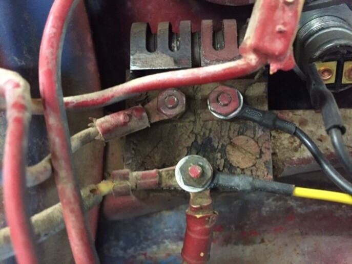

Picked up a 1948 8N recently. Tractor starts easily and runs like a watch. PO fitted 12 volt battery and changed nothing else. From what I can tell, the generator, harness, regulator, terminal block etc all appear original or correct replacements.
Where would I measure voltage to the points, or look for a ballast resistor? What would be the correct voltage to look for?
The 12 volt battery is new, otherwise I'd just go back to 6 volts and leave things as they are. I am not familiar with the front mount coil/distributor setup and don't want to fry the points. I seem to recall that a JD 420 I had years ago was 6 volt and had a ballast resistor also. Thanks.

Measure voltage to the points at the primary connectIon on the top of the coil. If the coil is still 6V
you need an additional ballast resistor in the primary. Not needed if the coil as been replaced with a 12V version.
Obviously the generator (if still 6V) will not charge your 12V battery but if you don't have lights and keep it on a battery tender the tractor will run for years like that.

I do have 12v to the coil, but don't know if the coil is 12v or 6v. Need to clean the crud off the coil and see if there are any markings.
Obviously if there is 6v coil in place, I'll need to put a ballast resistor in the circuit or the points will burn up. Easy to do if that's the case.

Should already be a ballast resistor on the "3 terminal" terminal block. You will have 12v to the coil when points are open. No current flow, no voltage drop!

I know you said everything else is original, but just for grins, measure the voltage coming out of the generator while it's running.

Ya, I was wondering the same. If it has been working ok for him, probably a 12 volt generator. Pictures would have been good!

Hood is off.... gas tank full of rust. So I can't run it right now and check the generator output.
Here's pictures of the generator and the terminal block, which has the original ballast resistor. I still don't know if the coil is 12v or 6v.
