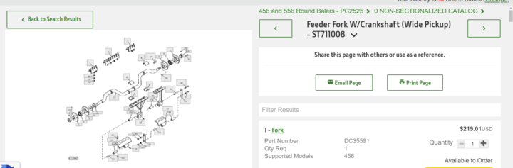

I need the part number for my 456 SS
round baler....i need one of those forks
that feed the hay under the pick up. I
just need the fork part that bolts on.
One of the side ones, not the middle. I
can't find it on the parts diagram.

DC35591 is outside fork
Viewing that parts schematic reminds me of when I purchased a new JD 466 Mega-wide pickup. I lost track of how many of those same feeder forks I lost while baling hay. The crankshaft that those forks bolt to got enough wear so the fork tip banged on baler frame sufficiently to break fork mounting bolt. I put both edges of plastic brg "U shape" on a belt sander to lessen plastic brg to crankshaft clearances.
IMHO placing rotating crankshaft under pickup attachment was not one of JD engineers most shining moments. Baling in sandy soil as I do a lot accelerates the CS journal wear.
Later model balers with newer style MWPU PERFORM GREAT

I searched the internet & didn't find a cheaper one. With the limited number of rd balers utilizing that part it would surprise me if it was available aftermarket. You might find that part at an equipment salvage yard on a salvage baler That part fits 20 rd baler models. If I still owned(which thank goodness I don't) I'd investigate installing the later model much better designed MWPU which I think can be accomplished.

Does that plastic bushing piece come with
the fork or how does that work? Is it
easy to replace...looks easy. I ordered
it. The one that is broke lost two
fingers....I been using it. You think i
can use it awhile yet?

Plastic brg halves are part # CC56259 which sub to DC56256 @ $87.76 each. I read on another site that part # includes four brg 1/2's but I don't determine that reading JD parts description. Brg half installs similar to engine crankshaft brgs.
I hope you checked parts page I posted before you ordered the fork because I just noticed RH & LH forks are different part #s. Sorry I didn't notice my mistake sooner. I should have paid more attention to reading parts description like I was instructed by dealer 56 yrs ago.
