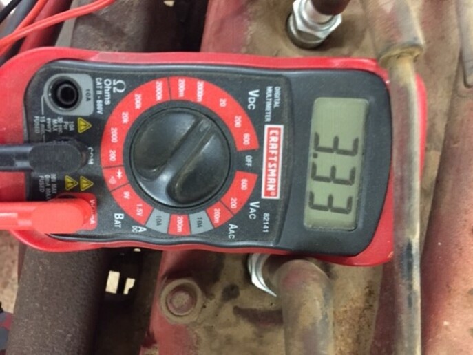

I measured the voltage at the coil, with points open. 12.5v as seen in the first picture.
I then bumped the motor until the points closed. Second picture. It would appear the original ballast resistor is dropping the voltage to 3.33v. I don't know if that's a correct number or not. If it is, then I will leave things as they are.
Thanks for all the comments.

mr.precision wrote:
(quoted from post at 19:11:45 06/17/21) I measured the voltage at the coil, with points open. 12.5v as seen in the first picture.

Don't you hate it when people perform simple reliable diagnostic checks and provide hard data with clear descriptions of test conditions. No endless churning threads with vague meaningless descriptions. Real killjoys Wink

PostPosted: Fri Jun 18, 2021 5:22 am    Post subject: Re: 8N with 12volt battery - all else original Reply to specific post Reply with quote
HaHa thanks for the "compliment".
I presume 3 volts is adequate, and that the factory resistor can function reliably dropping 12v to 3v.
As you know, a ballast resistor drops voltage and creates heat in doing so.
If/when the 12v battery goes out, I will go back to 6v and get the charging system in order.
For now, the current 12v battery and a tender will be fine.

mr.precision wrote:
(quoted from post at 09:22:58 06/18/21) HaHa thanks for the "compliment".
It was a compliment and well deserved. Personally I would stay 12v and fix the charging system to match
JMO,
TOH

I will try to answer Jerry's question. The ballast resistor, which is in the picture, reduces voltage to the points. I do not know what the voltage at the points should be with a 6 volt battery...... but in a vintage auto with a 12 v battery, it is usually 6-7 volts downstream of the resistor.
My 8N has the factory wiring, or replacement wiring, in place. The only thing the PO did was place a 12v battery in place of the original design 6v battery. AND he wired it up NEG ground. As you know, the original set up was POS ground.
The system seems to work and the 3.3v to the points appears adequate. So I'm leaving it as it is.
You might check the voltage to the points at the connection on top of the coil. If the points close, and you still have 12v, then let us know.
