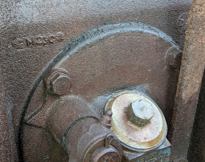

So I'm pretty sure I screwed up the previous reply and deleted whatever that person had posted, sorry. I'm adding pictures of the
casting numbers I have found on the tractor. I'm testing with one picture first. This is right side of engine just below the
cylinder head but centered on the block not towards the front as mentioned.

SkipperII
So these are the casting numbers I can find
1st is right hand side centered under cylinder head
2nd is left Hand front just behind the pulleys
3rd is Left hand just above the clutch pedal

PostPosted: Sun Jul 04, 2021 8:20 am    Post subject: Re: Is this form channel still active? Reply to specific post Reply with quote
Your first picture is of a mould code so is the same on most tractors.
Second picture is a casting code which translates as: December/28th/1960
Third picture code translates as: October/23rd/1959
So from those she looks original.

Carboy400
New User
Joined: 28 Jun 2021
Posts: 9
Report to Moderator
PostPosted: Sun Jul 04, 2021 9:47 am    Post subject: Re: Is this form channel still active? Reply to specific post Reply with quote
@Majorman
I grabbed a picture of the casting boss where your number appears but that machined flat is blank on mine.

Majorman
Tractor Expert
Joined: 15 Jul 2002
Posts: 1588
Report to Moderator
PostPosted: Sun Jul 04, 2021 1:29 pm    Post subject: Re: Is this form channel still active? Reply to specific post Reply with quote
OK, we know for certain that your engine is a 1960 from the casting code so it looks like you have a very early Super Major. The engine in that is the same engine as fitted to the previous Power Major, in fact the only differences between the two was the Super had disc brakes where the Power had outboard drum brakes. The Super also had different hydraulics with Draft and Position control where the Power had the earlier straight up and down ones from the Fordson Major Diesel era. the Super also has a dif. lock.
Check for a serial number on an aluminium tag on the front of the firewall between the engine and battery box or check the clutch housing flange between the engine and clutch housing behind the starter.
The Super was introduced in October 1960 so it is possible that it slipped through without being stamped or it could have had a new block fitted and the number not transferred. The 1959 gearbox casting code could indicate that it had been laying around at the factory for a year which would not be unusual. The tractor is 60 years old and could have had a lot done to it in that time, it might even have had a Power Major gearbox put in, as I said, those items are all interchangeable right back to 1952.
