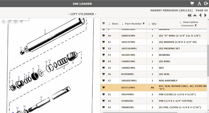

Is there a place to get cylinder kits for the 50A with 54 hoe and 300 loader. Agco shows individual seals and some NLA. I see lots of other brands with full kits.

You can try a place like Baum Hydraulics, there are others, and see if they have kits for yours. You will likely need cylinder bore, rod diameter and cylinder number (at least some MF cylinders had part numbers stamped in them).
Or take the old parts to a hydraulic shop and have them matched up (again having bore and rod diameter can help).
The online AGCO parts books does show some kit numbers, they may or may not be available, you would have to check. Again you need to ID your cylinders as there are options for the same positions.

According to the agco parts book for the 300 loader.
Page 32 for the dump cylinders the kit is part number 835792M91
Page 34 for the lift cylinders the kit is part number 835717M91
