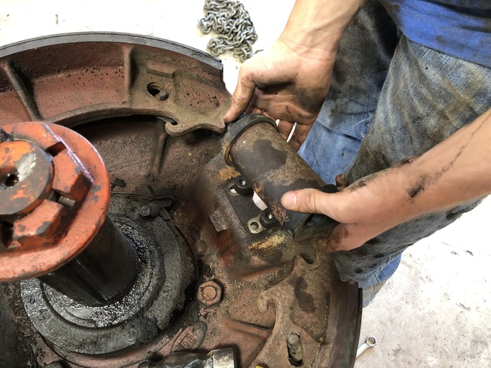

Have a 49-La Case that needs rear brakes replaced. Anybody has any experience taking break cover off axel? I have been told that this could be a hard project to get apart. If anybody would have info on this I would apricate that

I have done them, its not a bad task. Remove the tire/rim assy by removing the lugs scattered around the wheel. The big nut comes off the axle next and then a puller will remove the wheel/drum. There are puller bolt holes in the wheel. It is heavy, like 300-400 lbs heavy, so use something to handle it.
What exactly is wrong with your brakes? Could it be possible they need fluid and bleeding or do you know that they are sure enough bad?

Here is a visual of what you will be dealing with on the brakes.
Your shoes may be OK, but I would bet that your master and wheel cylinders are full of rust.
