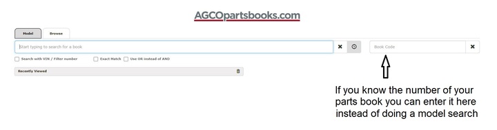

The OEM manuals are available for purchase at: https://www.agcopubs.com/ . Even if you don't purchase, there you can use that site to get the manufacturer's part number for the manuals you need. Having that number aids in getting the right ones if you shop used or reprints.
You can access the AGCO family parts books online for free at: https://apb.agcocorp.com/ . You can use the parts book to see what seals your engine and transmission have.
