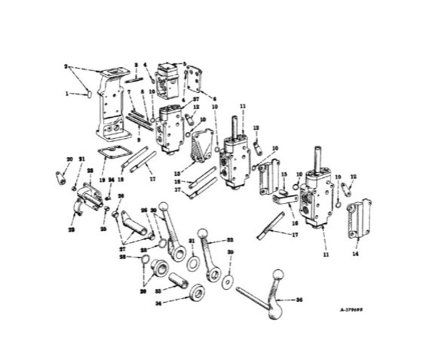

PostPosted: Fri Jan 14, 2022 11:42 am    Post subject: Re: Hydraulic Valve Help Reply to specific post Reply with quote
So, another question. I have a junk 300 with 2 more valves on it. I'd like to add a 3rd valve to the bank. How hard is that? Would I have to have any other hardware or could I just use the existing? Thinking about tearing the valves and regulator off the parts tractor and rebuilding them, then replacing the ones on the runner with the rebuilt ones later on. Make life a lot easier, I would think.

PostPosted: Sat Jan 15, 2022 7:05 am    Post subject: Re: Hydraulic Valve Help Reply to specific post Reply with quote
Mac, you can add a third valve to the stack, as that was an option, but you also need the control lever hardware to run it, and in fact the entire control lever assembly may be completely different between the 2-valve and 3-valve configurations.
