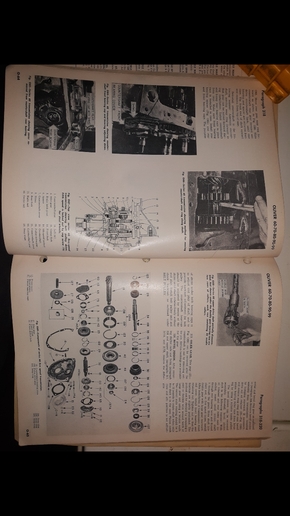

The detente are a ball bearing and spring on the shift shafts that hold them in place. They get dry and rusty from sitting or the hole can get enlarged causing them to stick. Not sure where they're on a 60. On later tractors they were on the front of the trans. Might try to get some penetrating oil worked on the shafts and work them back and forth gently.

PostPosted: Sat Jan 15, 2022 10:30 am    Post subject: Re: Oliver 60 Row Crop Transmission issue. Reply to specific post Reply with quote
Here's some pics from a IT manual. Hope you can see it. One pic shows detents. Hope you can make sense of it.
