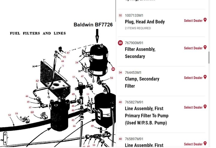

Final filter I use is Baldwin BF7726.

The link below should open the online 555 parts book. Check out page 58 Diesel fuel lines and filters and see which two filters you have (they show three possibilities), and you can get MF numbers to have cross referenced at your local supplier. Note the 767900M91 does not cross to WIX or NAPA, it does cross to the BF7726 Dieseltech posted for you.

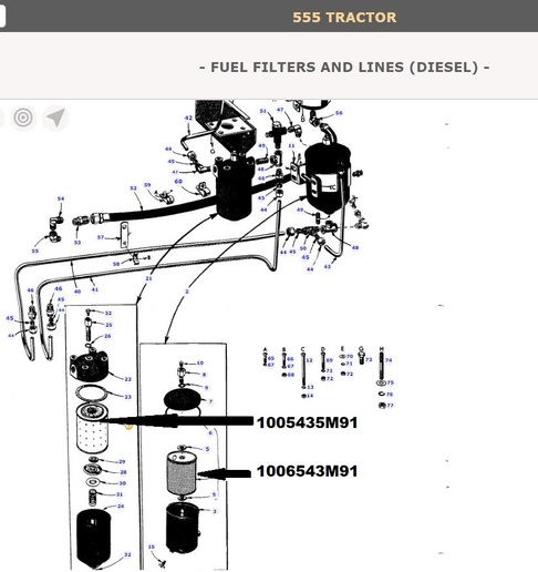

From the Agco parts book.

The Cannister option for the secondary filter that Dieseltech mentioned.

That must be the one Jim, thanks to all who replied.

Thanks go to Dieseltech for the Baldwin number.
