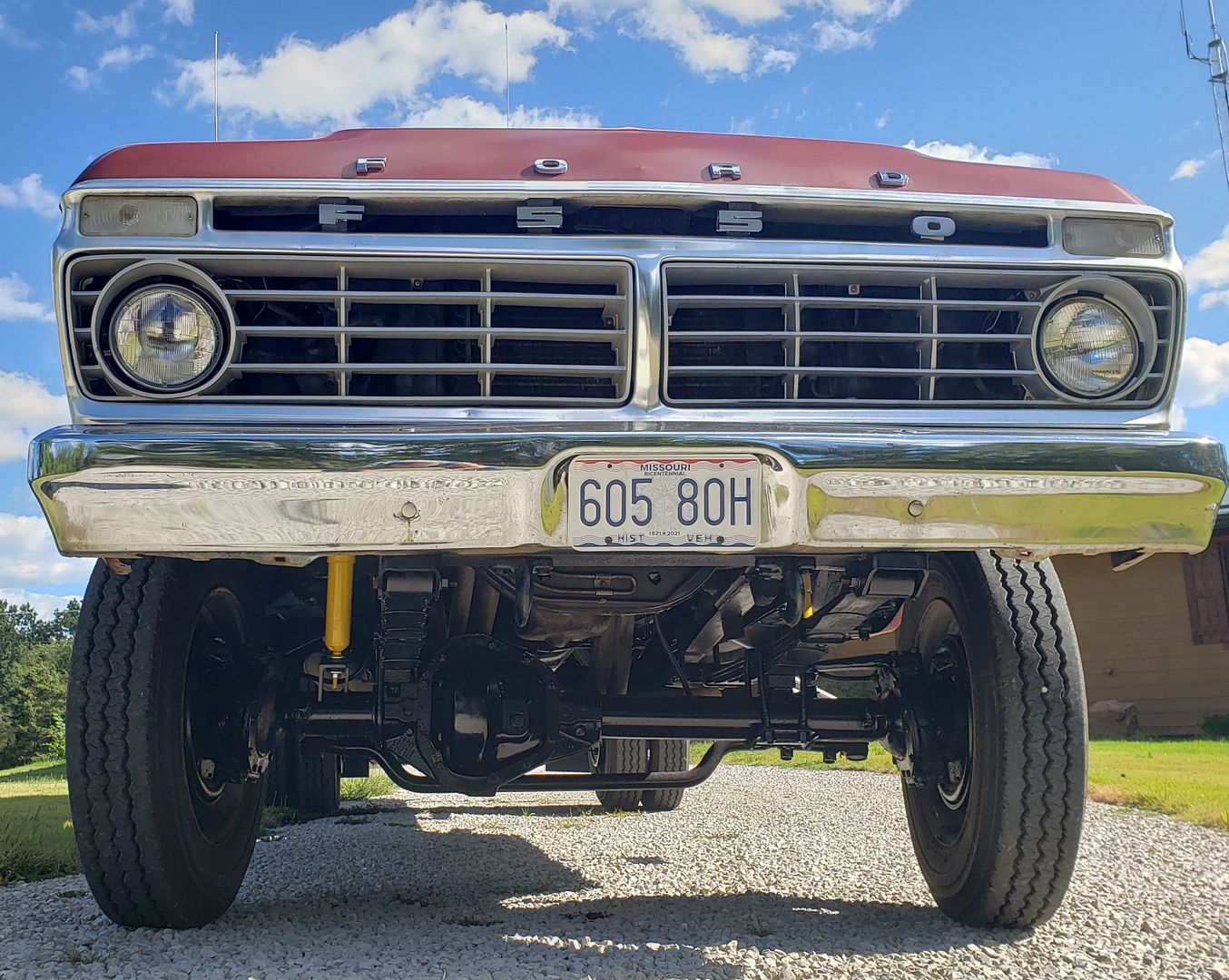

Hey DoubleO7,
From what I gather from the previous owner, the truck is a "State Surplus Dump Truck" from Springfield MO. The axles are an Eaton Rear low pinion Limited Slip rear axle. The front is a Dana 70 with an automatic locker. They are 4:88 gear ratio. They look factory to me and some other Ford Guru's.
The transfer case is a Divorced INTERNATIONAL 205 gear case, Passenger side drop probably made by New Venture.
As for the grill, take a closer look. It's not a doubled F O R D Emblem but rather F 5 5 0.
Never in my life have I seen anything like it. I've taken it to several car shows and the Ford guys say it's the Unicorn.
I am very happy to own it and use it.

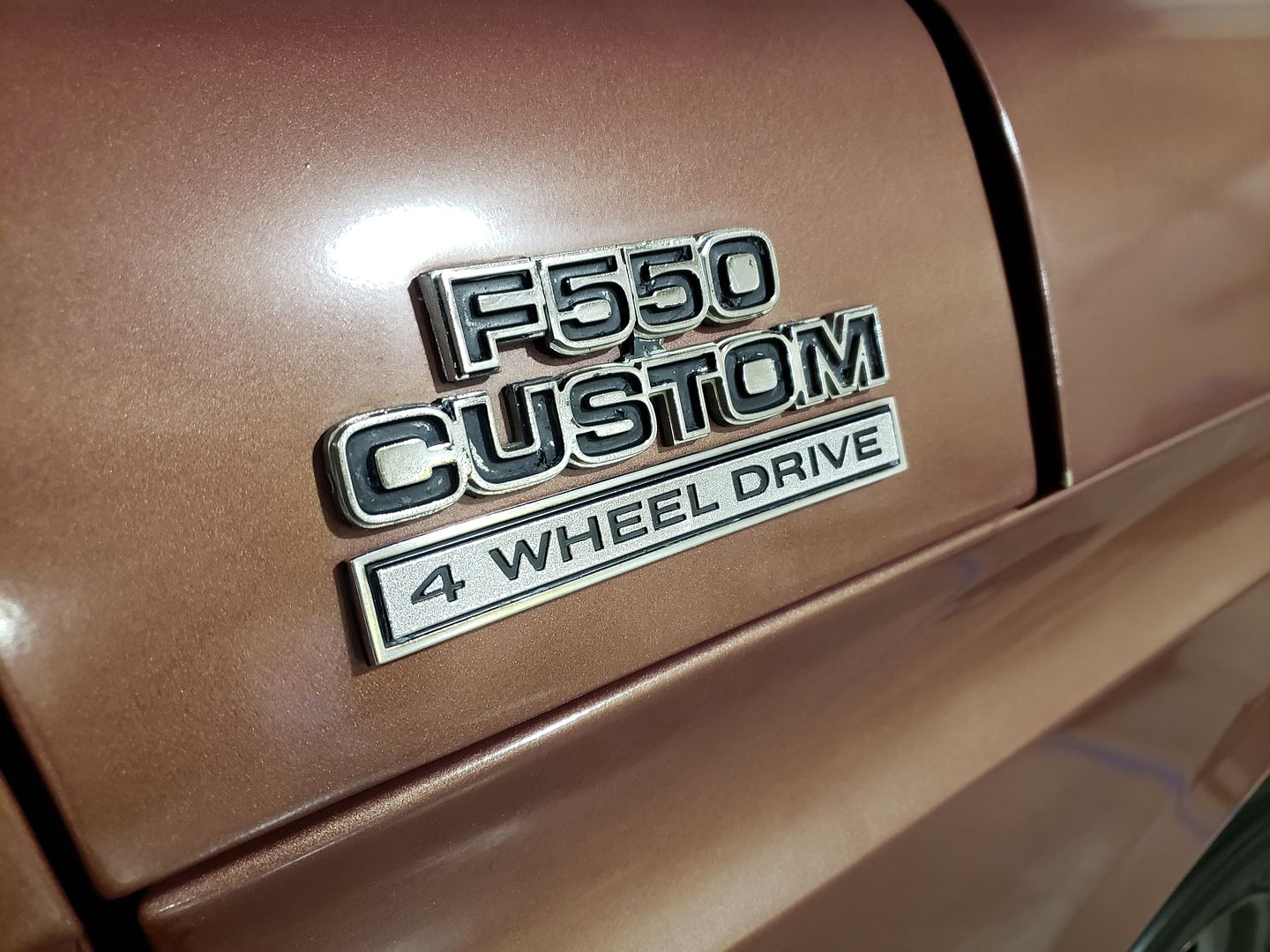

DoubleO7,
Here is the picture of the badging.
As for the VIN, I believe it starts out with X41 I couldn't find anything on it. It seems that the VIN tracker ends with the F-350. The truck has a NP435 4 speed and "Had" a 400 in it. I did a 460 swap on it.
WC

PostPosted: Thu Nov 24, 2022 8:20 am    Post subject: Re: FORD / IHC 4x4 Dump Truck Reply to specific post Reply with quote
An F41 indicates a 4x4 F450 per wiki which might not be right.
A real dearth of info finding any F550 with that body.
I suspect the a truck outfitter was utilized (axles) or some prior owner customization in it's life (F550 in the grill vs FORD).
But, maybe not.
Ford fleet vehicles can be real oddballs.
