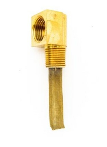

My carb does not have a screen in it. At some point it was not replaced but I have an external fuel filter. Did a flow test and all good. Today I took the petcock apart and cleaned it but it look good. Pulled the fuel inlet line off the carb and blew it out. No screen. Before I went to the electrical I thought I would try it. Good news it ran fine. Bad news I m not sure why but I will use it a few times now and see if the surging comes back. New step condenser :?:

Did you remove the whole fuel shutoff assy. from the tank, there's a screen in the tank. Also 2 fuel pickups in there, one is for reserve. Did you remove the glass fuel bowl and remove and clean the screen above it? Do you have an aftermarket inline fuel filter in the steel line from the shutoff to the carburetor? Is that what you replaced?
To do the fuel flow test did you remove the plug at the bottom of the float bowl and then turn the fuel on and see how long it takes to fill a pint jar?
