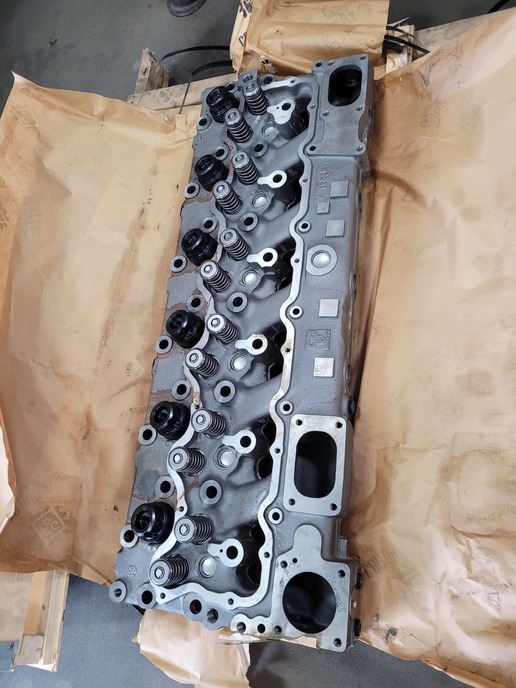

You are correct, it does have a belt driven pump. The head showed up yesterday but I wasn't able to get to it and look at it until this evening. It is the wrong head.......... I have to wait until Monday before I can get ahold of them and start the process to exchange it.

CVPost-Old Magnet wrote:
(quoted from post at 14:06:59 03/18/23) Correct cylinder head part number is a 5S1884 with a casting number 2S2970
Finally got the book, it's saying 8M0694. 5S1884 is a cross but I'm finding a bunch of conflicting info about it. Loaded or bare, decompression lever provisions or not etc
The one I ended up would bolt down but I think the valve cover bolt holes are different and no decompression provision.
The head I pulled off has casting number 2S9790, I'm not sure of the casting on the new one. The part number on the box is 1P4303, and it has the enclosed intake casting.

1P4303 part number does not show on my interchange list.

1P4303 is for the D333c

For your engine you have the correct number if you can find it
that 8M0694 matches in the book. 5S1884 shows no
decompression lever assembly although there is one plug.
Does it still have a pony motor?
