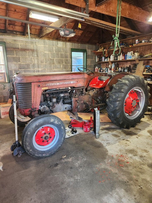

Thank you Tractor expert and Tractor Guru for the responses. My plan indeed was to replace the rod bearings because I thought I might have heard a knock one time, and while I am doing that, I thought I'd go ahead and replace the front and middle mains. I was not considering splitting the tractor. I do not have a service manual. I just checked, and the good news is that the rod bearings and the crankshaft journals all look good enough to go. Nothing I can catch a fingernail on. It looked like the original bearings. I did an oil test earlier, and the lead was 200 ppm. I thought maybe I'd get lucky, but now I am concerned about excessive end play. .032 inches. I didn't think to check that earlier. What is the crankshaft end play supposed to be?

So, I guess I will order a shop manual. I am wondering how I will split the tractor with floor jacks. I hope that if I get it apart I can find the right parts. I'll try to review as many of these posts here as I can. It had a new clutch recently. It doesn't have a whole lot of time since it had a valve job back it the 80's. The spark plugs have oily deposits on them. I only use it for mowing 4 acres and for the Souder loader, which I couldn't do without. We'll see what happens. Should be fun. My Father bought this tractor new in 1958. The picture is of me in the 60's.
