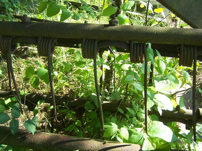

I have a david bradley hay rake - and I am having trouble locating the correct teeth. Sloan sells some teeth for the rake but the specs are different than the teeth I have on the rake - ,mine are shorter no hook and the end and the coil is less than two inches. Sloan lists them as DB1 - any ideas where I can find / adapt teeth to fit -Thanks

I have an A&I Products printout for all rake, baler, and tedder teeth. A&I Products is an aftermarket supplier.
A-DB1 (fits David Brown)
A-531727 (AC)
A-539754 (AC)
A-462978R1 (IH)
A-64562 (Ford/NH)
A-40917 (Ford/NH)
A-107058 (Ford/NH)
The others part #'s I listed look and mount very similarly but are different in certain dimensions. My best guess is that some other teeth may have made their way onto your rake if someone bought from say TSC or the like. Another possibility is that A&I decided to alter the part slightly to make one part fit 2 applications so it may no longer be an exact match to original but will still work in function.
Do some searching on line and see if you can find the "A&I Products rake teeth" in a *.pdf file format. It will have all the pictures and dimensions listed so that you can determine which one you want. Assuming you find that pdf on the web then please post back with a link. I printed my list about 3.5 years ago but I can not find the original source again for some reason.

Thanks for the reply - I am sure that the teeth I have are the ones that came with the rake - I have two different David Bradley rakes from different sources and both have the same teeth - the major hang up is the teeth they have listed have a hook on the end where mine are straight going through the bar to hold them in place.

Kevin, is this the type of tooth you are looking for? We have two DB rakes in the weeds. Would the used teeth be something you can use?

Yep that is the style - would be interested in them - Kevin

Two wheels in front that drive the rake and two smaller trailers in the rear. the teeth look like the picture GarryinNC posted before your message - Kevin

Okay if you do not luck out on any of those used teeth then I think the part number that you need from A&I Products would be A-T17350 based on the photo posted in this thread.
A-T17350 dimensions are:
a) 7.125" (tine tip end to bottom of coil spring)
b) 3.750" (Bottom of coil spring to the pin that goes into bar)
c) 2.187" (diameter of the coil spring)
Says it fits Case-IH rake 1953. Again see if you can find the catalog online or look at your dealers picture and dimensions.
