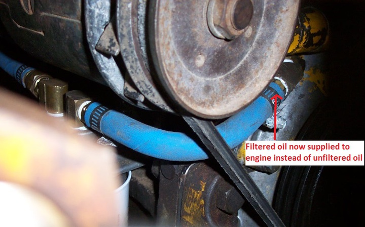

PostPosted: Thu Jan 12, 2017 12:31 am    Post subject: Re: Massey Harris 333 oil canister Reply to specific post Reply with quote
This is what I did to my MF2135 Industrial with the Continental Z134, made it a full flow system (I didn't care if it was 100% restored). Now the engine/bearings gets filtered oil instead of the filtered oil being dumped back to the oil pan. I have since changed some fittings to make it look better. It has been trouble free so far (I'm quite happy with it).
