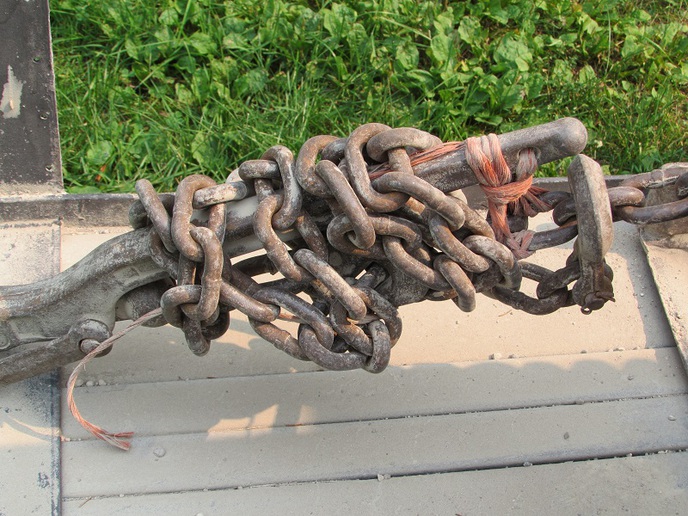

As mentioned previously, the accident I was in resulted in the trailer fishtailing wildly for quite some time (lots of G-forces!), plus that the trailer rolled over and then righted itself before jackknifing into the tow vehicle. In the process of rolling over, the trailer tongue twisted and the trailer hitch came completely off the trailer and was still hanging from the tow vehicle.
Again, this little tractor (only 1,500 est.) stayed exactly where I had planted it on the load. Any straps that went over the top were long-gone, but the worst of the chains only wore through half their thickness. So no matter what ANYONE tells me, I know that in any situation where rubbing or friction-skidding is concerned, steel will ALWAYS win out over fabric.
Most every strap I had on that load was completely scrapped, yet only one chain needed to be replaced, and actually hasn't yet been as I just used it to help tie down a Gehl 4625 SX skid loader. And no, wasn't using this in any sort of primary holding capacity!! I just haven't replaced much of those straps yet. Besides, I can get a lot more UMPH! from load binders and a cheater bar than I can from a small ratchet. ...And for those of you who say load binders should be outlawed (and ARE in some states!), the reason is the ability of the handle to pop open, loosening the load. Here's a pic I took of how I remove that problem. Most people will say to simply wrap the excess chain around the handle, but sometimes there's not enough chain to keep me comfortable. In this case there was ample chain, but I still chose to use multiple wraps of heavier baling twine, THEN wrapping the excess chain.

The handle on my binders is designed a little different than yours and I put a bolt through handle and link of chain. I than wrap rest of
chain around complete binder.
