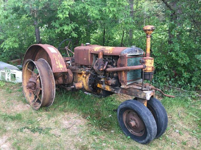

Hello, my father has a Minneapolis Moline Twin Cities tractor, but we are not sure what model it is. I think it might be a 1936 or 1937 JT. I'd appreciate any help I can get. Sorry the photos are not very good, the tractor is currently in "storage"

Yes it is a JT with a MM replacement engine. I have a 36 JT with a MM replacement engine that in 400 newer than the engine in my 37 MM ZTU

Thanks R Aiken, The place in the hood where the air cleaner comes out looked pretty "after market". So I thought it might not be original. What kind of MM replacement engines do they put in these? Would it possibly be from a MM Z?

Yes, it was common to put the Z engine in them.

There was a bulletin on how to retrofit a Z (RE) engine into a JT. The transmissions are almost identical except the ZT was about 9 inches longer in the bell housing area.
It looks like whoever put your engine in skipped the part about shimming up the radiator and gas tank. That would probably have put the air cleaner completely under the hood.
I have a JTU with the Waukesha (JE) engine in it.

Thank-you for the great information and the nice picture of your tractor. Looks like a great project!
