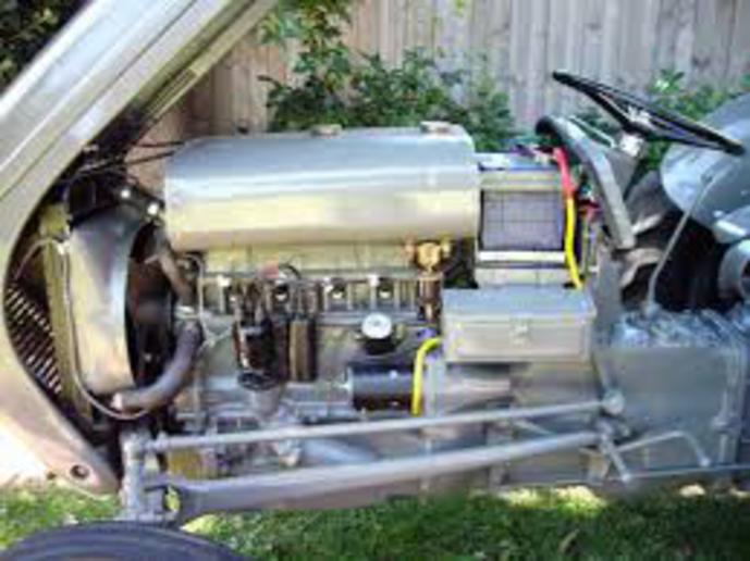

I finely "CLEANED" and changed my Ferguson 6 Volt Starter leads as per this picture I located on the Internet. Now the STARTER spins the Engine perfectly:
Back to top
View user's profile
John Deere D
Tractor Expert
Joined: 14 Jun 2011
Posts: 3077
Report to Moderator
PostPosted: Sat Dec 30, 2017 10:26 am    Post subject: Re: Starter trouble to30 Reply to specific post Reply with quote
OK second try:
No battery connection to any part of the DASH:
Bob..
