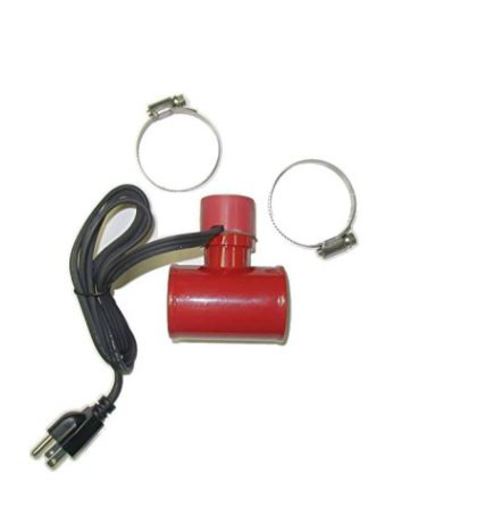

I am going to get a magnetic heater to help warm the tractor up before I start it this winter. My question is it more beneficial,to put it on the oil pan or the engine block and heat the water?

Folks who live in places a lot colder than I do here in VA will argue about battery blankets or magnetic oil pan heaters as compared to lower radiator hose heaters or dipstick heaters. While the consensus leans toward lower radiator hose heaters, I can?t offer a personal observation; the only thing I?ve ever used to heat an engine was a 100w light bulb laid against the intake manifold. Magnetic oil pan heaters on the intake manifold will help as well.
If you have AC power to the tractor for the heater, use a float charger too. No matter what else you do, the battery must be fully charged. A float charger is helpful; not a trickle charger, but a float charger. A battery charger, even a "trickle" charger, left unattended will eventually boil out a battery. I use float chargers for two reasons: battery longevity and a sure start. Battery sulfation occurs at a specific rate at "X" temperature. Over time, sulfation reduces battery performance and eventually its effects are irreversible. Sulfation of batteries starts when specific gravity falls below 1.225 or voltage measures less than 12.4 for a 12v battery, or 6.2 for a 6 volt battery. Sulfation hardens on the battery plates reducing and eventually destroying the ability of the battery to generate current. Using a float charger significantly reduces sulfation. Your battery loses 33 percent of its power when the temperature dips below freezing, and over 50 percent of its power when the temperature falls below zero. A fully charged battery will not freeze until -76?F; however, a fully discharged battery can start to freeze at 32?F. So??keep the battery fully charged! If you have a digital volt meter, 6.03 volts on a 6 volt battery and 12.06 volts on a 12 volt battery is only a 25% charge! I use Deltran battery tenders on all the tractors, the golf cart & 29 Ford. Pricey, but they work & have in-lines fuses. All are hard wired to the vehicles.

It's cold enough here for the oil pan to act like a heat sink. I have better luck putting the magnetic heater on the intake manifold.

I put mine on the bottom of the hydraulic sump. Unless it's well below 0°, I generally don't have a problem starting (just have to mind not to flood it with too much choke). But if the hydraulic oil is cold, it can take 15-20 minutes of running the tractor before it warms up enough that lift action speed is 'normal.'
That said, I literally just ordered two more right before checking in here. One will go on my Boomer 8N sump, and the other will go on the '50 intake for when temps are really cold (as we're expecting in the next few days).

I went to put one on the oil pan of my Kubota yesterday but it doesn't stick to it, so I put it on the side of the block. I prefer the oil pan if it is steel since heat rises.

A 1500 watt heat gun aimed at the intake manifold and carburetor for a few minutes works for me.Even a propane torch to heat the intake up works (but not as safe)keeping the battery up to snuf with a tender helps tremendously.

I hang a heat lamp, aimed at the manifold side, to warm up the carburetor/manifold, during the winter. I leave it on 24/7 so the tractor is ready to go whenever I need it.

Thanks for the replies, I was just going to ask the question about using a heat lamp, question answered. I know the inline heaters work better, but I am not doing that this winter so I got the magnetic heater today. With that and a heat lamp it has to be way better than nothing.

And not much better if it is. Those rad hose heater cost more than they should, but worth it. If you just.need to get by, put the magnetic heater on the pan and have a maintainer on the battery. O h yeah. Some sort of padding for that cold iron seat to protect ur hind end

IMO the Katz lower radiator hose is the only way to go. Some of the nay sayers think the coolant must be circulated for it to work. I plug mine in about an hour before starting at -20F. Touch hand on head and it feels warm. Tractor starts right up like 40F. A little tight fit installing but well worth it. I tried a magnetic one on the pan and really not a good place on the N to put and did not seem to heat much at. Again my opinion and experience.
