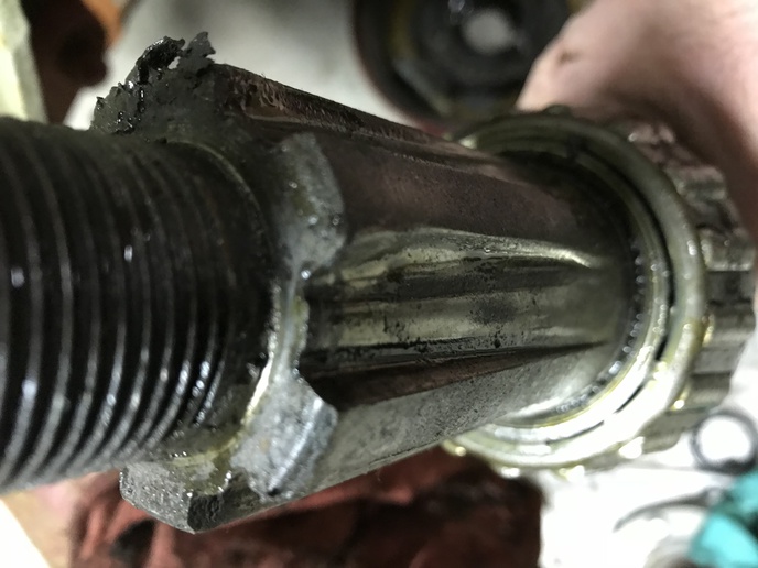

we pulled the right side axle apart on my 53 NAA, splines are shot, hub is shot and the shims where in pieces. The axle nut was just a nut, no spring no slot and no key. the axle has no slot for a key or spring. is it possible they have been replaced once before?

It is, of course, possible, but more than likely, it is just worn out.

Good Pix when you get a new axle post a pix of it to go with this post.. I have seen the axle turned down and re-threaded...

It is worn out. My question was why is it different than it should be. It doesn't really matter because I have to replace it I was just curious if anyone else has seen an axle like this.

I will, we are going to pull the left side apart as well to see what kind of shape that one is in also.
