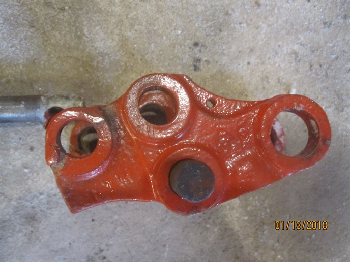

Does anyone have any easy ways to remove a frozen rocker pin. My rocker is broke, and the eyelets where the pin goes through are wore out bad.
I have heated it, and hammered on it, but it won't budge. Now I need a new pin also.

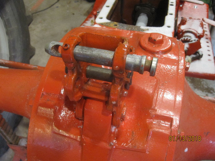

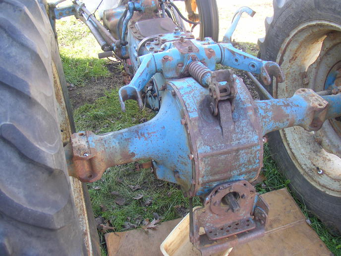

Had the same problem on a 641 that was left outside
for 30+ years (uncovered). My top link socket was also
broken off like yours.
To speed up the process I drilled a small (1/8 hole)
in the middle of the rear casting to allow P blast
to get in and work. It took 2 weeks of constant spray
of lubricant before I noticed that I could beat the
pin a little. At that point I hit it back and forth till
it came out.
Pin was completely salvageable in my 821 rear end.
And son in law welded TSC collar in place of the
broken top rings. I didn't want to spend $100
for a new top link rocker.
I figure I can add a grease fitting into the hole for
future lubrication.

Some pics
Donor 641 after removal
821 rear and reclaimed pin
Welded TSC COLLAR

Finally warm enough to work outside again. I drilled a 1/8" hole into the back of the rear end housing into the rocker pin today. I put some PBBlaster into the hole, and on the sides, again. I then came back 20-30 minutes later, I hit it with my small maul, and it moved. I got it out. Now I have to rebuild the rocker some how. Since it's cast steel. I can weld on it. I'll see how it goes.
Thanks, Pat
