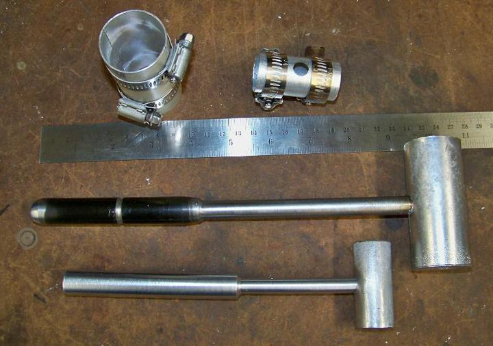

They can be used to repair almost any shaft that has a rubber seal, used two on the brake cross shaft to fix a leak on my 3600.
After the sleeve is installed the aluminum installation tool supplied makes a great mold for a lead hammer.

Bob, what am I looking at, a Speedi-Sleeve?
I got a measurement......shafts OD. = 22.18mm sleeve I'D =22.07mm. The sleeve is from the repair kit.

PostPosted: Tue Jan 16, 2018 3:36 pm    Post subject: Re: Steering Shaft Repair Kit (SRK632AA) Reply to specific post Reply with quote
You are looking at what I did with the aluminum installation tool that comes with all Speedi-sleeves, just threw it in in case you or someone else wanted to repurpose the aluminum..
From your measurements the sleeve you have should work, shaft is 0.11 mm larger than the ID of the sleeve?
