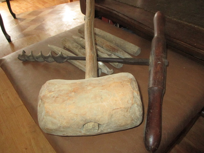

I think these tools shout about the ingenuity and frugalness of yesterdays builders. The pegs and maul built on site from limb wood.
I ran a National truck crane for 3 years. Worked for 2 different Contractors who bought and tore down old post and beam barns, bent by bent. They told me the peg maul was traditionally left with the barn after completion. I really enjoyed those deconstructions, and learned a lot. The barns were reconstructed as far away as Texas.
Watched a couple of episodes of "Barn Wood Builders" last weekend on GAC. They were making pegs and using a similar home made maul. They had a chainsaw set up with a foot to make mortises though, and a holehog to drill the holes.

You wrote: "They told me the peg maul was traditionally left with the barn after completion."
I am assuming this was so that pegs could be tightened occasionally due to shrinkage and possibly some settling of the structure?? How "heavy" would the mauls typically be?

Thanks so much for this post! As stated the maul would be left to give the pegs a tap now and then. Sounds good. Could also be a good luck tradition or could be a superstsion about the tools life is finished and tied to that building. Metal hammer could break the pegs. If you buy a real log cabin they settle and cure over several years and they have adjustment points in the building. Green wood does that and no construction crew is going to wait around for the wood to cure. He he. Also green wood is much easier to work with. If you go into a really old beam and peg barn or building you will see that almost every floor beam, roof rafter, etc. Has a slight permanent sag in it. That is from green wood.

I am guessing about this one, but around 8# I guess, would have been a bit heavier if it was green wood. They could make them as big as they wanted. The one they were using on the TV show was bigger than this one.

One more thing about the maul. Notice that the hadle is a straight "stick" of wood. This way you could use it close or reach far up, and the handle would fit your hand the same over it's length. Not like a hammer handle with a bulge or tapper in it. Just fascinating to think about all of this neat old stuff.

The handle and head were just a limbs cut off a tree which they made beams from. They cut and formed the maul head, drilled a hole in it with the same bit used for the pegs and found a limb that they could fit into it. Not a lot of engineering and ergonomics involved. It is just a simple site made hand tool to do a job.
