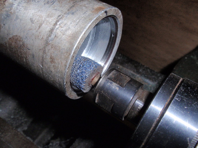

I took a Shindaiwa 680 chainsaw on trade. It wouldn't start and seemed to be a little low on compression.
Upon teardown, I discovered stuck piston rings with slight gauling.
Everything cleaned up really nice and I wanted to replace piston rings.
After exhausting all my parts resources, I decided to modify a new set of rings.
Rings were the right diameter with the correct thickness for piston grooves, but they were too wide (piston grooves weren't deep enough.
I am fortunate enough to have a lathe and decided to grind the inside surface of rings. Could have just ground by hand but decided to do it right.

Nice job on those rings. Impressive thinking !
