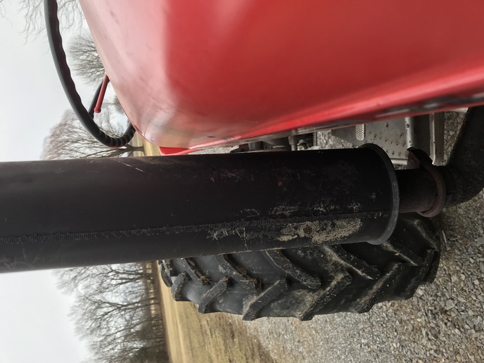

Has anyone changed their TO 35 Deluxe horizontal exhaust to a vertical exhaust? I spoke to Dave at Yesterday's Tractor and he said to use manifold elbow 181886M2 and vertical muffler S43644. Dave also said the diameter of the muffler is 4 1/2 inches. My question is will this exhaust assembly clear the tractor body and not lean against my original Ferguson Deluxe decal? I have the Continental engine and the tractor is a 1958 model. Thanks in advance for any help.

I have a 1963 MF 35 Deluxe with the z134 and a vertical exhaust. I will try to post some pics this weekend of the clearance it has with the hood. There is not much.
Thanks. I wait for the pics. Much appreciated.

I found these pictures on the net, they may or may not help you. I have a 55 TO35
deluxe but it has a horizontal exhaust.

Wow, thanks for the pics. That really helps.

Thank you for the photos. That really gives me a good visual. I think the elbow you have is the same as the one I'm looking at on YT. Another person posted about exhaust in the face with this set-up. Is that a problem for you? My greatest concern is starting a fire with the horizontal exhaust. Fire danger is high here and I need to clear some rabbit brush. Thanks again for the help.

I have 1/2 inch gap between muffler and hood
