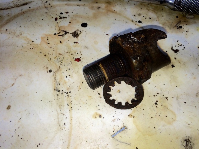

What's the technique for removal of the crank pulley on the front of the z-129 engine? What I'm looking at is not what the IT manual shows. The "crankshaft starting jaw", apparently a bolt that will catch a hand crank for manual starting, is buried within the pulley - maybe it's missing a washer or something? I can't get a socket/wrench on the flats, I could get a pipe wrench on the exposed part, but am wondering if I am missing something?
the other thing I am wondering about is the coolant pump housing - I've removed two nuts that apparently attach it to the block, is that it? It seems stuck real tight yet and I don't want to break anything -
thanks, David

just a suspicion, but I'm betting that the internal toothed lock washer is not original equipment - and it certainly wasn't tight against anything when it was in position -
I am in the market for the appropriate washer for this application if any of you have such an item available -

There is suppose to be a starting jaw washer behind the crankshaft starting jaw. The Ferguson part # you are missing is 1 750 149 M1

The reason the water pump is tight is because there were suppose to be 3 nuts holding it on. Remove one more nut and you should be in better shape.

I got the pump housing off cleanly - I had removed the pulley and pump (which is the third nut), but the housing was held tightly around the stud just from debris and corrosion - a bit of work, but it finally loosened up

You pulley has the four holes to accept a coupling to perhaps drive a hydraulic pump. That would have had a bolt in it and not the crank bolt
that you have.

Yes - I used a pipe wrench to grab the the jawed bolt - it came out without much struggle - had to use a puller to get the pulley off -

those four holes are untapped and don't go all the way thru the pulley - they are plugged with rubber plugs - I'd guess you are right, they are for a coupling for a pump, maybe something held in place by the crank bolt, dunno -

5/8 inch-18 UNF x 1-1/4 inches, this is the bolt you need and a flat washer to properly put the pulley on correctly
