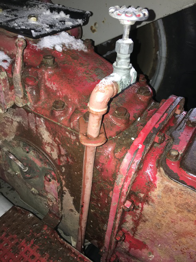

So while we are on the subject of hydraulics...while out plowing the snow (again) I figured I should ask this of y'all... What do you make of this? I have not even attempted to open the valve and it's not really in my way, but I can just see my pant leg getting caught on it sometime in the future. My uneducated guess is that it was used for some sort of implement in the past? What's your take?

The fitting that screws into the aluminum pump housing is kind of an odd thread or I would recommend you remove the entire stand pipe. As it is, you could remove the elbow by the valve and cap it off.

It had a loader on it, plumbed off the test port.
That pump port is threaded 1/2-20 straight thread. You can buy a straight thread port fitting or you can make one from a 1/2-20 bolt. Or, check w/ The Old Hokie and see if he still sells the really nice test port gauge fitting.

OK, TY for the replies. I was thinking front loader but figured I'd see what others had to say. I'll probably remove it completely and put a plug in it. Apparently UPS is holding the new PTO assembly and ORC hostage due to the recent snow, and with more expected 2moro it's likely I won't see it till mid week, which is fine.

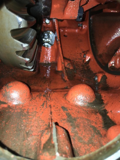

Well, apparently UPS was to afraid to drive down my road today...not sure why, I went out twice. Needless to say the PTO assembly is still not here. That didn't stop me from draining the fluid and pulling the old PTO. I'll be damned if I could break loose the main plug on the pump...drained it pulling a bolt next to it instead. I was able to get the one under the trans off though, but it took just about all I had in me to do so. What tool do y'all use to break em' loose?
Anyways, here is a shot of the inside of the rear end. Doesn't seem all that bad to me. I felt around the inside of the trans drain as well and it felt clean there too.

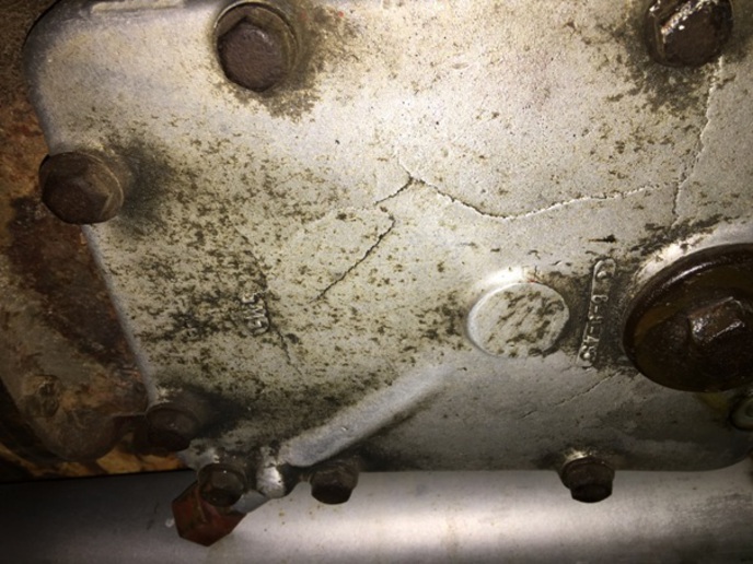

PostPosted: Mon Feb 12, 2018 5:22 pm    Post subject: Re: Swapping PTO Soon Reply to specific post Reply with quote
This is kinda scary though. No leaks, but WTH!

PostPosted: Tue Feb 13, 2018 1:13 am    Post subject: Re: Swapping PTO Soon Reply to specific post Reply with quote
Those cracks could have been in the mold when casting the aluminum. It may be hard to see with the pump installed but the tell of the tale is whether the fissures are visible on the top side of the casting.
