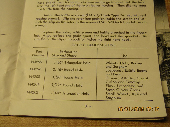

I picked up a McCormick 80 pull type combine with a grain cleaner at a auction. Just tried using it and believe there is a part missing in the cleaner attachment. I am guessing there should be a round screened drum that the cleaner paddles pass the grain through. I am also guessing there should be a few different drums with different sized holes for various grains. Don't have a parts book nor can I find one. Does anyone know the part number for these drum or am I totally off base in assuming a part is missing. Any idea where I can get parts or a parts manual for this cleaner?

Yes the scourclean unit (I assume that is what you have) requires a screen for the product you are running, I tried looking your machine up on the cih on line parts but it does not list the model 80 there that I can find,, I may have a ops manual still for them,, I have a box or two of IH manuals I will see if I have one you should be able to order the parts and ops from a cih dealer, I would take your serial# with you if you go that route, this site may also have them for sale

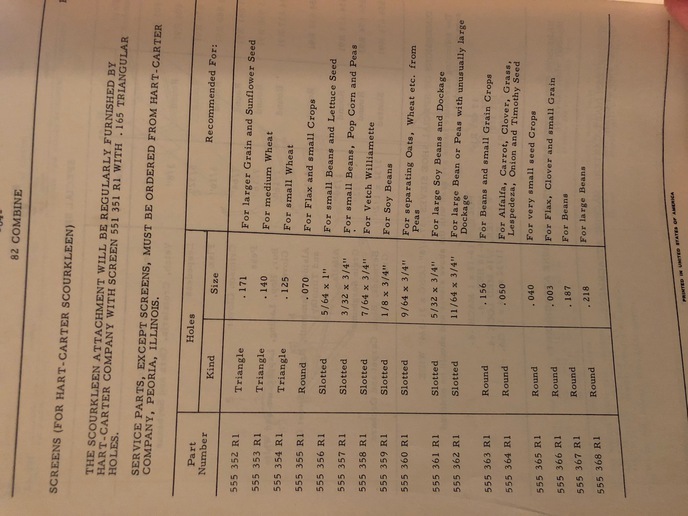

Yes, the Skour-Kleen is what it is called, and it was not made by IH - it is a Hart-Carter. The grain stays IN the drum - the weed seeds go OUT of the drum. Your screen size should be slightly smaller that the grain size you are harvesting. Weed seed is smaller in size, so it passes thru the screen.
There is an IH manual for it - and they have IH part #'s for the different screens. I have the manual - somewhere, lol. I'll see if I can find it.
BTW, that Skour-Kleen is the same on IH 64, 76, 80, 82, 91, 93, 203, combines - they all use the same unit and screens. I want to say they list all the screen part #'s in the combines parts book. Most other brands of pull combines use the same unit, as well. The size is correct for a smaller machine. They all use the same size screens, too.
The one thing about the old IH stuff - they are not listed on the CIH website. Especially anything from IH of Canada - which is where most of their small combines were made, I think in Hamilton?
I usually buy the manuals off ebay - once you have the part number you need, it is amazing what is still out there on the inter-web.
And, sometimes there is nothing out there. Never hurts to look.
If you should strike out, you can make your own - I made one for soybeans for my 82 combine. I just found the slot/hole size, ordered a sheet of the correct metal from McNichols Co., snipped it to fit the Skour-Kleen, and away I went. It worked pretty well - took out alot of the pod husks.

Here is the one from my IH 82 - these are the same for the 80.

Thanks for all the help. Unfortunately I have not been able to fine a screen to buy. Now that I've seen what the look like I am going to try to fabricate a few for my wheat, oats and soybeans. Thanks again. This is the first time I tried using this forum glad I came across it. It is GREAT!
