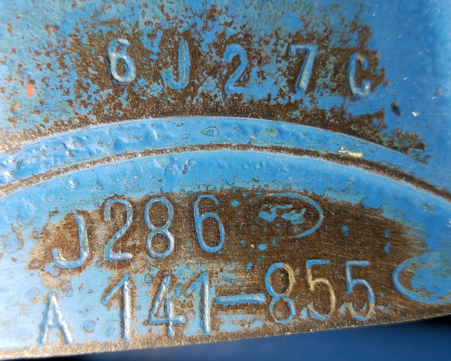

I just bought a ford 3000 that are believed to be a 1968 model. The serial number begins with an a. From everything I find this means it was manufactured in Belgium. I find that hard to believe. It has the 8-speed tranny and live PTO. Not sure about the diff lock yet. I'll get some pics up as soon as I can.
The numbers are:
6J27C
J286
A141-855
It has a shift issue where the shifter comes out of the shift forks and jams up. It has the stamped steel shift plate. The fellow I bought it from said he was told that the shifter plate assembly was worn and needs replacing. Anybody have experience with this? I've searched and searched and haven't found anything posted about a similar issue.

ID numbers:

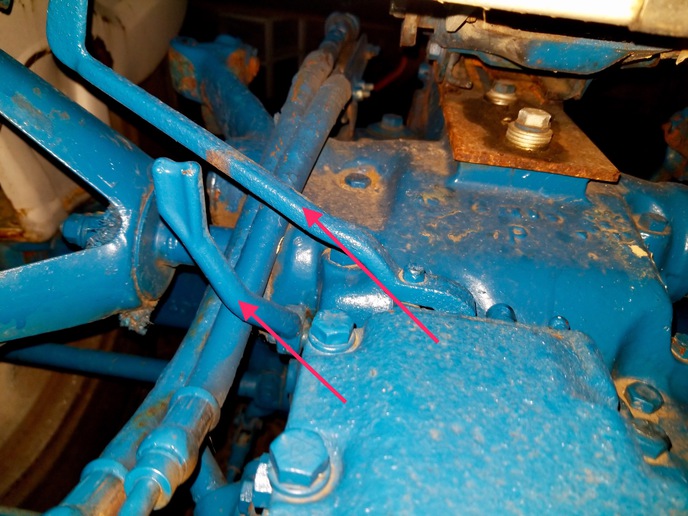

So, can someone tell me what these two levers are?

Congratulations, Those are the controls for a dual spool remote hydraulic valve. You can control 2 hydraulic circuits (2 lines each) with those 2 levers.
You can see one set of lines to the left of the valve in your picture.

Is not the small lever draft/position control?

The A141-855 is a serial number. The A at the beginning says that it was assembled at the plant in Antwerp Belgium.
6J27C and J286 both appear to be date codes. They apppear ot be 1966 date codes. My guess would be that the transmission was assembled on June 27 and the tractor was assembled on June 28, or possibly it was near the end of the assembly line late on June 27 and got stamped with that date, but it didn't actually get finished until the next day so they stamped it again.
There should be an additional number stamped farther up into the rough part of the casting that would be the model number, but on those early European thousand series models they didn't always have all of the numbers and some were in the wrong place, like on the flat spot on the left hand side of the tractor instead of the right side.

Yes, I am pretty sure that you are correct. The smaller one is the draft/position control selector lever. The larger one appears to be the handle for a single spool remote valve that controls a single hydraulic circuit that is a double acting circuit. Although it may be a dual spool remote valve with the second handle missing. I would have to see it from another angle to be sure.

Single spool lever in right of picture and the draft/position control lever on the left.

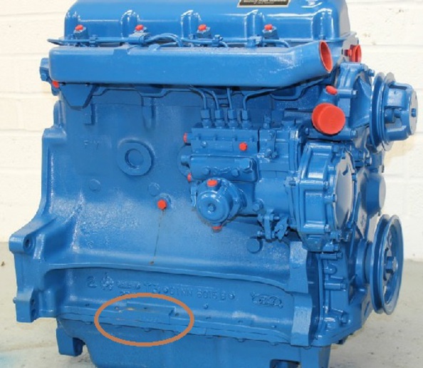

P7008A isn't anything meaningful that I am aware of. Look on the very botom of the engine block on the flat rail just above the oil pan on th eright dside. The engine serial number should be stamped in there. If it is a 3000 then it should start with an "N" or a "C". If it's a 1966 3000 it would start with an "N". Below is a picture of where the engine serial number is located. The picture is of a 4 cylinder 5000 series engine, but the serial number is in the same location on a 3000 series.

The ESN is:
ND203482J166
