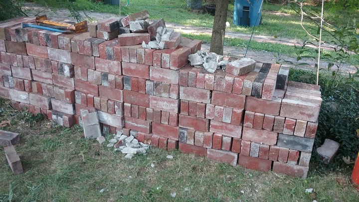

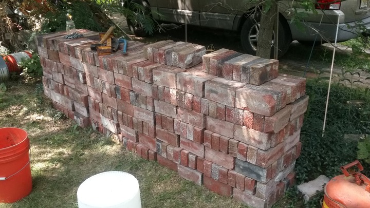

In town on a side street they are totally referbing an older small house. Built in the early 50s. It even had lath and plaster walls. As they got into it there was so much watee damage on one side they stripped it right down to the basics. Repair and reframed. Add a rear room. Also a second floor with three small bedrooms. The house was totally done in brick. They took it all of because as they started working the crummy cement just started breaking loose. I saw what was going on and asked if it was ok to grab some. No problem. They filled an entire 17yd dumpster level full of brick. I was able to grab four loads of brick with my little trailer. Can only carry so much brick folks!! I scored 600 bricks for two days work. All cleaned and ready to extend my little brick driveway. Looking in that dumpster you just want to cry. Thousands and thousands of bricks.

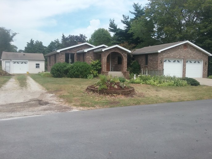

35 years ago, when I was young and foolish, I bricked my house. It took 25,000 brick. Glad I didn't have to clean mine before laying them.
If I ever get the urge to brick another house, I'll sit down until the urge passes.

I use an air chisel like for doing body work but you want to turn the
cfm. down so it kinda chuggs. You angle a paddle blade just right and
most of the time the mortar just pops off. The bricks from this house
almost all of the cement was grey. Was hard but it didn't knit into
the bricks. I was just tapping it right along the edge of the joint
with a wreck bar. Pop...off it came. Didn't even need a masonry
hammer. I wish I had somewhere that an entire loaded dumpster...could
be dumped. Such a waste of perfectly good bricks.

They look like a brick made by NJ Shale brick co,,they will hold up well for your driveway

Sometimes the reason the mortar doesnt stick good,,those brick are really dry ,they can suck a lot of water,,in the hot you can spray the brick with water ,let them sit a bit,,then lay them in mortar,otherwise the dry the mortar so fast its hard to lay them

So I would guess this house was built in the middle of August. There were no tie in straps in the bricks and only a single layer of them. They just touched the wall and the bricks just started to fall apart. Just want to cry about that dumpster full of bricks.

I bought my new brick from the brick factory for $.23. They are clay brick, fired in an old kiln

Very very nice work!! How long did it take you to do that?

So that means this pile that I have ready to go is equal to 1/41 of your house!
