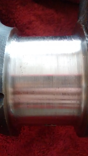

Posted some of this on the main for advise, but to continue a topic I opened a month or so ago, decided to follow Old's advice and rebuild the motor right. Got the crankshaft out and up with me at school--plan on getting it ground. I *think* it needs to be ground, not just polished, but maybe y'all can give me a better opinion with the pictures. I do have a micrometer and can measure the journals but I don't know what they're supposed to be. Been quite an adventure so far, especially when the engine stand rotated before we were ready!
Plan as of now is to just do the mains, rods, and cam bearings right now. I really can't afford to do everything in 1 go, so I figured do the bearings this year, wait another year or 2, then do the cylinders and head. Reason for rebuild was low oil pressure, but I've never had any indications of head problems or compression problems, so I figure with as few hours as I put on it, it'll get by until I have enough capital to fix the rest of it. Manual says I can do the head and cylinders w/out splitting it again so thats what I plan to do. Let me know if I'm crazy. Any advice anyone has going forward is much appreciated.

Ok I had a micrometer and measured the journals.
Per the service manual, the Mains should be: 2.9974 to 2.9984
Per the service manual, the Rods should be: 2.3085 to 2.3095
These are measured from front no 1. cylinder to no. 4
Main 1: 2.986
Main 2: 2.986
Main 3: 2.982
Rod 1: 2.290
Rod 2: 2.300
Rod 3: 2.290
Rod 4: 2.300
I *think* the bearings are half groove, but I'm not sure and can't get out to look at it right now (we're in the hurricane at the moment).

PostPosted: Thu Sep 20, 2018 1:09 pm    Post subject: Re: 1010 Gas Rebuild Reply to specific post Reply with quote
Do NOT reassemble with standard bearings!
According to your numbers the main journals have already been ground .010" undersize.
If the numbers are accurate it appears that you have 2 different grinds on the rod journals(.010" & .020") which is rare but not completely unheard of.
If you do plan on using this crank you'll need to ensure that you get the correct size bearings for the job & at an absolute bare minimum confirm clearances during assembly with plasti-gage.
This particular type of scenario has cost many engines over the years.......

PostPosted: Fri Sep 21, 2018 1:53 am    Post subject: Re: 1010 Gas Rebuild Reply to specific post Reply with quote
Uh-oh...
Max bearings I can get for this crank are .020 over. The journals are scored up pretty bad and probably need turning again...so...
Sounds like I might be buying a combine in the near future. Be cheaper than buying another crank off ebay...

You could take the crank to an engine machine shop & have them double check the measurements & give their assessment on whether the crank will "clean up" with a polish to the journals that are already ground .020" & get a quote to grind the remaining journals to .020"
Unless you know the condition of the crank in the combine / machine you plan to buy or have an agreement with the seller for reimburesment if the crank is not salvageable you may very well be in the hole further........
