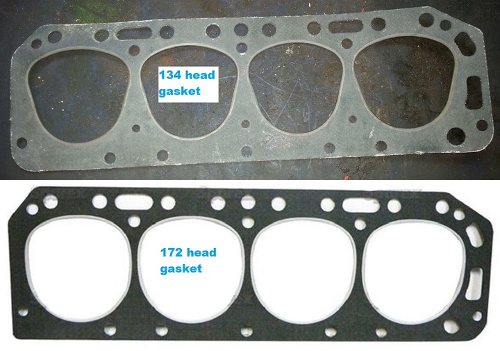

PostPosted: Tue Oct 09, 2018 9:16 am    Post subject: Re: 2000 134 gas head on early 172 gas block Reply to specific post Reply with quote
Interesting thing is the 800, 2000, and 4000 gas 4 cylinders use the same part number for the cylinder head. I'm guessing they lowered the compression on the 4000 by putting a larger dish in the piston. As the head gasket goes the bore is bigger for the 4000 than the 800/2000. In order to get the same compression ratio of 7.5:1 out of the 134, and the 172 you only need to loose about 21cc's from the combustion chamber. The difference in the bore diameter of the head gasket between the 134, and 172 probably makes up the roughly 21cc needed to lower the compression in the 172.

PostPosted: Tue Oct 09, 2018 9:19 am    Post subject: Re: 2000 134 gas head on early 172 gas block Reply to specific post Reply with quote
Dang it no edit, the only difference between the 134, and 172 piston if the diameter of it.

PostPosted: Tue Oct 09, 2018 4:38 pm    Post subject: Re: 2000 134 gas head on early 172 gas block Reply to specific post Reply with quote
Thats quite a bit of difference. I still have some tetraethyl lead I could use. I sure miss those Sunoco dial your octane pumps. I'm going to put this in a loader that I only use when needed. It has a diesel in it now but with a loader on everything is harder to get to.
