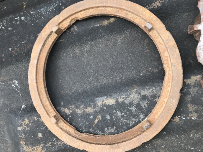

Anyone know what these plates fit? The look similar to IH and Covington planter plates but I think they're Different.

Top plate looks somewhat like Blackhawk

The (2) plates on the right side of the picture with the smaller centers I am thinking are for a Cole MX series planter?? That is just from Googling images of different plates.
I am still not convinced on the Blackhawk Planter Plates being the other ones?

The two are definitely Cole plates used on a variety of Cole planter models,the other two may be the outer ring of the cotton plates for the really old Cole planters.

Ok. They all came together. And I have several more plates than those.

The top picture are the 2 items on the right the same with one bottom view and other top view? The plates don't looke like they would fit the same planter, drive notches look different. The Blackhawk planter plate has a rounded top to center but the actual center is open. Don't actually look like Blackhawk but that is only planter I have heard of that has the raised rounded center to them. I have never seen a Covington planter as they were not sold here in Ohio.
