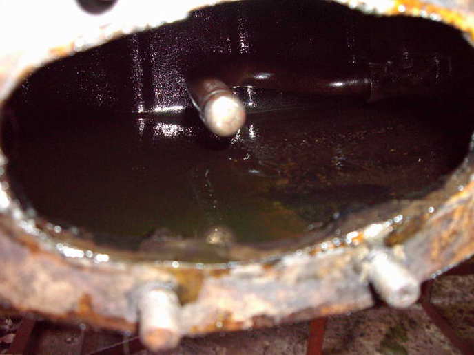

I have removed the oil pan with no mishaps. So far so good! Now to remove the rear seal retaining block (I think Bob referred to it as the bearing retaining block since it holds both the bearing and the seal). I noticed in a couple of pictures that Bob posted, that the block appears to be held in place by 2 additional bolts towards the interior of the engine. I have added the one picture that I saw the bolt heads behind the retaining block. Do these bolts hold the lower part of the retaining block to the upper half of the bearing block and do they have to be removed prior to removing the lower part of the block? It would appear from the picture that it does but I want to make sure that I do not make any mistakes here. I am currently removing the oil pan gasket from the engine block to allow the bearing block to easily be removed when I get to that part. Thanks Ron

PostPosted: Fri Oct 12, 2018 3:18 pm    Post subject: Re: Replacing the rear crank seal on a TEA 2085 Reply to specific post Reply with quote
Yes....Remove these two BOLTS:

PostPosted: Fri Oct 12, 2018 3:30 pm    Post subject: Re: Replacing the rear crank seal on a TEA 2085 Reply to specific post Reply with quote
"Do these bolts hold the lower part of the retaining block to the upper half of the bearing block and do they have to be removed prior to removing the lower part of the block?"
Yes, those bolts hold the main bearing cap in place - and they will need to be torqued to specifications when you replace them
"...allow the bearing block to easily be removed ..."
ya - probably not - you'll remove those two bolts and likely find the main bearing cap still firmly fixed - the seals on either side of the cap are compressed into place there will be no slop - - you'll need to be careful - after removing the bolts I'd take a plastic hammer and gently tap the cap first one way then the other (toward the inside of the engine, then the outside) and see if you can get a bit of movement - you have to be careful not to damage the bearing and not burr the cap or block when removing, so very small movements back and forth as you try to work it down and out - take your time and don't succumb to the temptation to stick a screwdriver anywhere -
